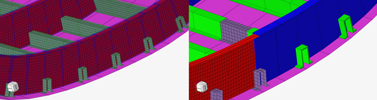

It also supports options to create surfaces/mesh congruent with beam nodes.
Congruent Mesh
If the connectivity option is set to Congruent with beams, then some shapes like: Channels (C, U) L, T (and variants) Bulbs, I are repositioned congruent with beam nodes no matter what the exact offset value if beams are connected to shell elements. The sign of offset along element normal will place created surfaces in correct side.
Whenever this option is active, the resulting mesh will be connected to beam node; mesh size will be honored only in remaining edges trying to achieve a panel mesh.
