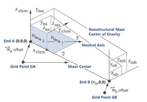

Elemental YZ Manipulator Use the elemental YZ manipulator as an incremental offset manipulator in elemental systems. The elemental YZ manipulator acts on the whole selection of beam elements. Each manipulation along the Y or Z-axis will append that amount to every selected element regardless of their current offset value. This tool is not meant to assign the same resulting offset value to all selected elements. Instead, the selected elements will be updated by the exact same increment.
- Click
- Use the Y and Z manipulators to manually adjust the offset.
- PressEsc to return to the Offset context.

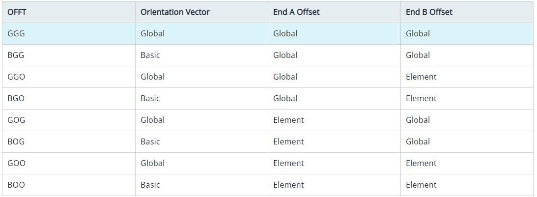

Offset Components Fine tune offsets by components. You can fine tune offsets in both the displacement system and the elemental system. Typically this is done when you need to update a large selection of elements.
- Click
- Enter the appropriate X, Y, and Z offset values and press Enter.
