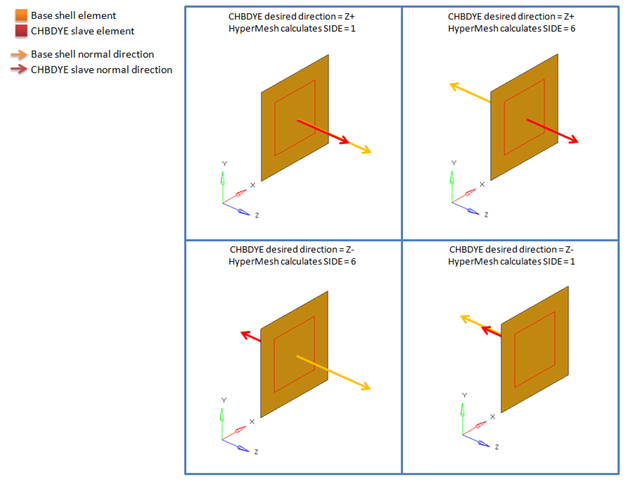

CHBDYE Side Conventions for 2D Elements
For CHBDYE secondary on 2D shell elements, HyperWorks will automatically assign a SIDE parameter value of 1 (top) or 6 (bottom), depending on CHBDYE normal direction. Use the Normals panel (Tool page) to change CHBDYE normal direction.
Figure 1. Resulting SIDE Value for CHBDYE Secondary on 2D Shell Element

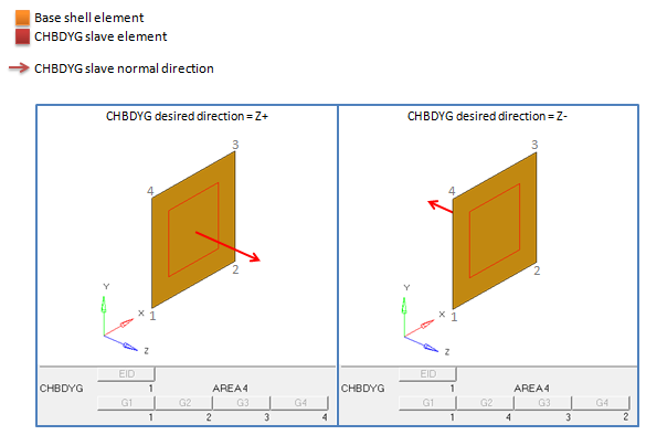

CHBDYG Side Conventions for 2D Elements
Figure 2. Resulting Node Order for CHBDYG Secondary on 2D Shell Element
