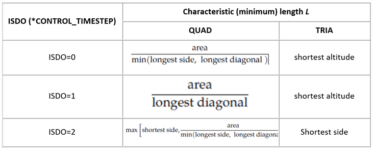

Elemental Time Step Calculations
Time Step Calculations.
Critical Time Step for Shell (2d) Elements
Figure 3.
Critical Time Step for Solid (3d) elements
Figure 4.
Figure 5.
Figure 6.
Where E is Young's modulus, ρ is Material density, 𝜐 is Poisson's ratio, K is Bulk Modulus, and G is Shear Modulus..
Characteristic length:
8 node solids:
4 node tetrahedras: Le = minimum altitude
