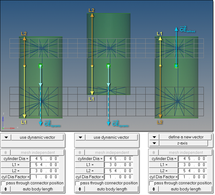

- mesh independent
- Use for realizations which do not need any mesh changes, and the connection is primarily defined via a solver-specific card or the nodes which need to be connected are defined by a cylinder, such as Bolt (cylinder spring) for Radioss.
- For all mesh independent fastener realization types, a cylinder is defined. Fastener hole detection is not performed because holes are not required. All of the nodes inside the cylinder are considered part of the fastener realization unless they also belong to a link defined on the connector.
- The cylinder dimension is primarily defined by its diameter, length L1
and L2.
- L1 points in the same direction as the connector vector and describes the distance from the connector position to the first end of the cylinder.
- L2 points in the opposite direction and measures the distance between the connector position and the second end of the cylinder.
- Therefore, the connector vector is essential for these types of realizations.
- If a vector is not predefined and is determined dynamically, the vector
will always point from the connector position to the projection point on
the farthest link.

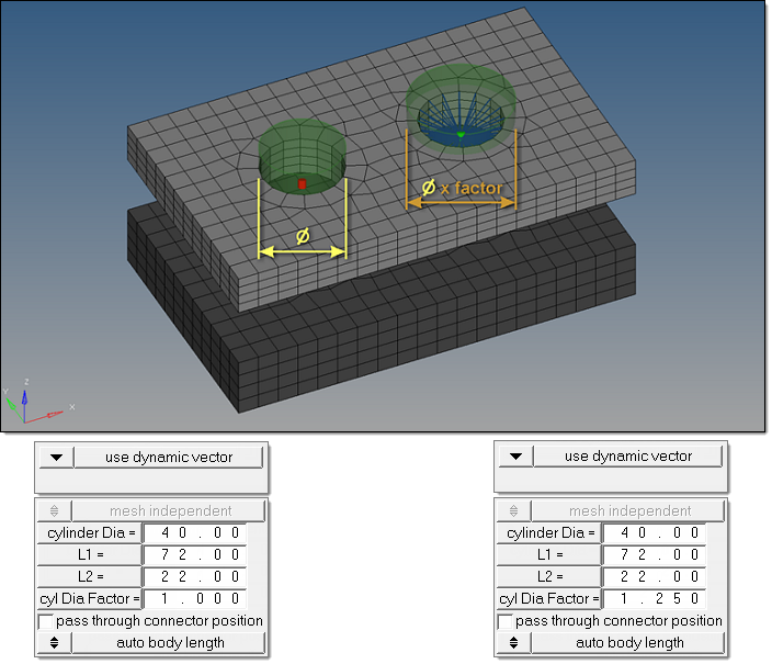

Figure 2. . Dynamic vectors have been used in the first two cylinder. Interchanging the values for L1 and L2 leads to very different realizations. By comparison, the third cylinder uses the same values for L1 and L2 as in the second cylinder, but the result looks better because of the predefined connector vector in the global z-direction. - In some automated processes, the cylinder diameter is automatically set
to the fastener shaft diameter. This leads to failed cylinder fasteners
when the holes are properly modeled because the defined cylinder does
not contain nodes. In such cases, the cylinder diameter factor has been
introduced; this factor is set to 1.0 by default and is a multiplier for
the cylinder diameter to increase the final cylinder diameter when
necessary. Note: The cylinder diameter as well as the cylinder diameter factor can be reviewed and modified in the Connector Browser. Connectors can also be rerealized with modified cylinder diameters and cylinder diameter factors without updating L1 or L2 in the browser. This is not possible from the panel.

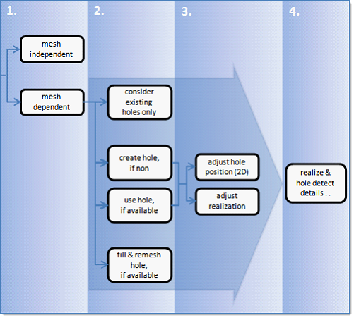

Figure 3. - mesh dependent
- Use for all other cases.
For mesh dependent types, you must determine:
- Is the existence of holes in each layer requested upfront?
- How should the 2D mesh be prepared before the final realization is performed?
In the past, a fastener realization always required a hole for each layer in the initial mesh. This is no longer necessary for 2D meshes because the imprint capability punches the needed holes into the mesh before the final realization is performed, enabling the mesh to be manipulated in a pre-step. This makes it possible to punch holes, move holes, close holes, create washers, and so on.

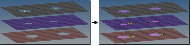

Under the Connectivity heading, select one of the following:- consider existing hole only
- A minimum of one hole per layer must be available in the origin
mesh. If holes do not exist, the realization will fail. This is
the default method and must be used for any type of solid
meshes.

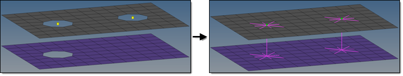

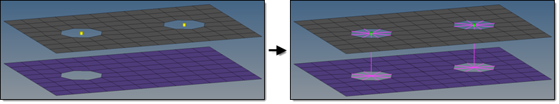

Figure 4. - create hole, if none
- If there are not any holes on a certain layer, they will be
punched into that layer at the position of the projection point.
The diameter of the new hole is defined under the Realization
Details heading. This method is used if the model does not
contain the appropriate amount of holes per fastener, but holes
are required for specific realization types.

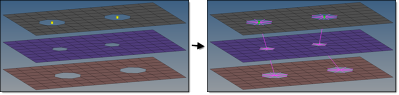

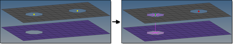

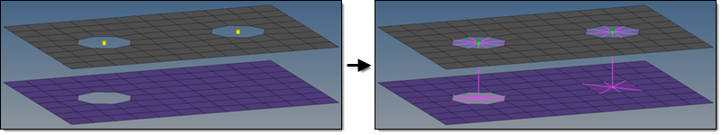

Figure 5. - use hole, if available
- Creates hybrids (hole on one side only), but other combinations
are allowed. On the mesh side (no hole), the connection is
realized via the head elements defined in the chosen realization
type. The head element(s) is/are created between the appropriate
body element node and the nodes inside the diameter
(no hole connection dia) defined
under the Realization Details heading. This option is used for
realization types which are not eager for holes.

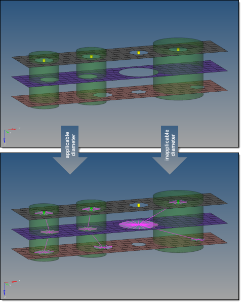

Note: The hole detection mechanism for the last three options takes into account a cylinder which is defined under the Realization Details heading. The hole consideration cylinder option can be defined as a factor of the no hole connection dia option or as an exact diameter. Principally holes which are inside or touching the cylinder can be detected, but the hole consideration is reduced to one hole per link per connector. Additionally, holes need to fit to the requested dimensions, which are also defined under the Realization Details heading. -
For the create hole, if none, and use
hole options, a mesh modification including a hole movement is
allowed. Therefore, you can determine whether to adjust the hole(s) or to adjust
the realization.

- The connector tolerance, especially when set to a large value, detects many holes. To prevent detecting holes which are far away from the connector position and are not aligned with the other hole(s), the consideration cylinder excludes outer holes from the detection.
- Since the existence of a hole is not
necessarily requested anymore, a space has to be
defined where the holes are expected to be. It is
no longer sufficient to use just the connector
tolerance, therefore the Hole
Consideration Cylinder option
performed along the projection path becomes
necessary. All of the holes the cylinder touches
or contains can be considered for the various
fastener realizations.
Figure 10.
