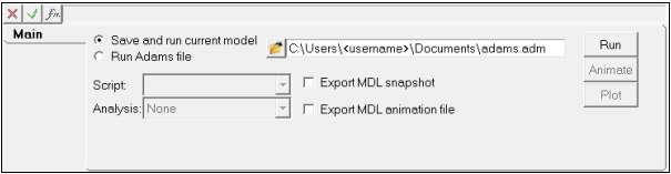

Figure 1. Run Solver panel with the Save and run current model option selected (Adams solver)

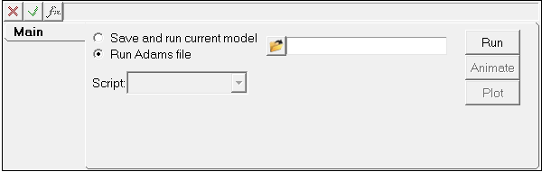

Figure 2. Run Solver panel with the Run Adams file option selected (Adams solver)
