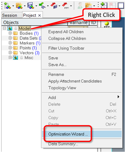

- Right-clicking on Model in the Project Browser and choosing Optimization Wizard
Figure 2.OR

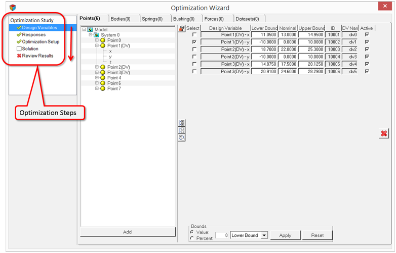

- From the Analyze ribbon, Optimize tool set, click the Reports icon.
Figure 3.
A red cross indicates that this step cannot be accessed; you have to complete the previous step(s) to perform this action. |
An empty check box indicates that this is the current step that you are working on. |
A green check mark indicates that this step has been sufficiently completed and you can proceed to the next step. |
Additional information about each step is provided in the following sections.
