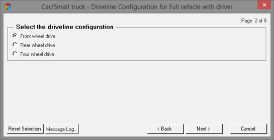

- Select the Full vehicle with advanced driver option from the Model Type window and click Next.
Select the Front wheel drive option for the model and click
Next.
Figure 1. -

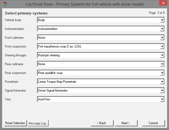

Select the primary systems for the model as shown in the following image and
click Next.
Figure 2. -

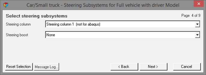

Select the steering subsystems for the model as shown in the following image
and click Next.
Figure 3. -

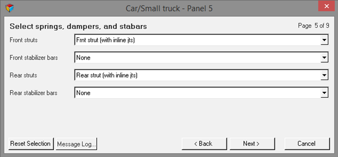

Select the springs, dampers, and stabars for the model as shown in the
following image and click Next.
Figure 4. -

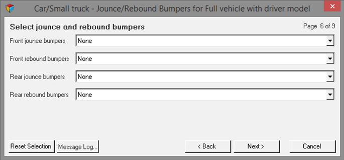

Select the jounce and rebound bumpers for the model as shown in the following
Figure 5. -

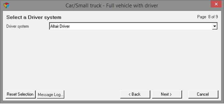

Now, select the Advanced Driver system and click
Next.
Figure 7.Note: The Advanced Driver is now included as a system. -

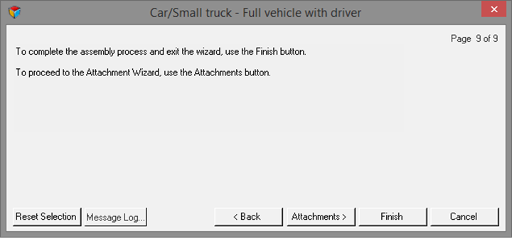

Now that you have selected all the required systems for the model, click the
Finish button to complete the assembly process and
exit the Assembly Wizard.
Figure 8.Note: Click Attachments button to proceed with the Attachment Wizard. -

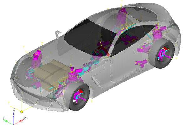

The Full Truck with Advanced Driver model built through the Assembly Wizard is
displayed in the graphics area.
Figure 9. - The subsystems you have selected in the Assembly Wizard to build the model are displayed in the Project Browser.
