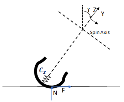

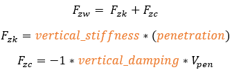

Vertical Force
Figure 1. Front view of tire at an inclination angle
Where
is the vertical stiffness of the tire. The lateral deflection is
ignored in the calculation.
Where
is the tire penetration velocity.
The vertical force can only be positive: in the case of a lift off condition of the tire from the ground, the resulting negative reaction force is set to 0.

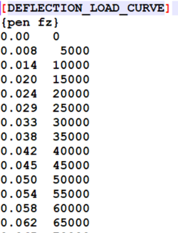

If a [DEFLECTION_LOAD_CURVE] block is present in tire property file, then the data inside the block is used to calculate the vertical force. In this case the VERTICAL_STIFFNESS value is ignored. The data in DEFLECTION_LOAD_CURVE should be monotonically increasing. An example of such table is given below:

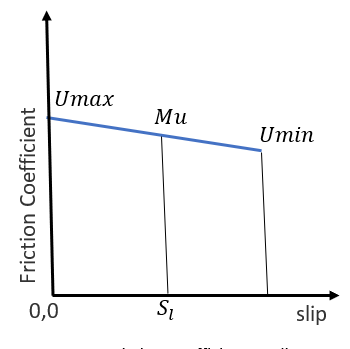

Friction Coefficient
The friction coefficient is calculated by interpolating the Umax and Umin value using Comprehensive slip.
Figure 2. Friction Coefficient versus Slip
If there is a [MU_SLIP] present in the tire property file than the friction coefficient is calculated by interpolating the data in the table. The data in [MU_SLIP] curve should be monotonically increasing. An example of such table is shown below:

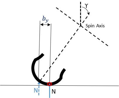

Overturning Moment
An overturning moment is caused by the shift of the contact point (at which the vertical force is applied) in the lateral direction.
Figure 3. Overturning Moment at the inclination angle

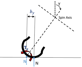

Aligning Torque
The same critical lateral slip used in the Fy calculation is also used in determining the condition of the tire.
Figure 4. Point of action longitudinal force which creates a moment about the vertical axis
