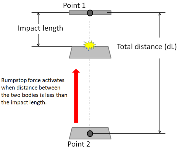

Install Methods
The AutoBumpStop install method is at design position and is used to determine the distance at which the AutoBumpStop force starts acting.
- Impact Length Method
- When the impact length is of value ‘L’, the AutoBumpStop force acts when the distance between the two bodies is less than ‘L’.
