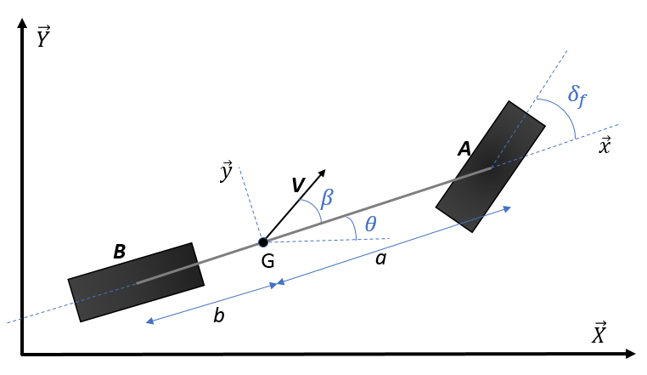

- Kinematic Bicycle Model
In Kinematic bicycle model, the equations of motion are based purely on geometric relationships governing the system. The major assumption used in the development of the kinematic model is that the velocity vectors at points A and B are in the direction of the orientation of the front and rear wheels respectively. This is equivalent to assuming that the "slip angles" at both wheels are zero. This is a reasonable assumption for low speed motion of the vehicle (for speeds less than 5 m/s). This model does not consider the vehicle’s dynamics such as slipping and skidding.
The kinematic equations of the bicycle model are written in terms of coordinates of the vehicle which gives our three degrees of freedom non-linear model
.The equations on motion written as a set of three differential equations where the state vector is:
Figure 1.The quantities are:
- Vehicle Yaw Angle
- Lateral Displacement of the vehicle
- Longitudinal Displacement of the vehicle
Equations of motion can be written as:
where,
- Velocity of the vehicle
- Rear axle to CG distance
- Slip angle at the center of gravity - Dynamic Bicycle Model

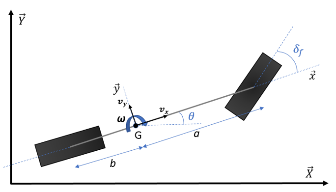

At higher vehicle speeds, the assumption that the velocity at each wheel is in the direction of the wheel can no longer be made. In this case, instead of a kinematic model, a dynamic model for lateral vehicle motion is needed.
The force equations of the bicycle model are written in terms of coordinates of the vehicle which gives our five degrees of freedom non-linear model
Figure 2.The equations on motion are written as a set of five differential equations where the state of vector is:
The quantities are:
- Lateral Velocity of the vehicle
- Yaw rate of the vehicle
- Vehicle Yaw Angle
- Road wheel steering angle (directly proportional to the steering wheel angle by a rack-pinion reduction ratio)

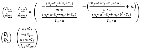

Using Newton's second law of motion, the equations can be written as:
where,
where,
- Cornering stiffness of (single) front tire
- Cornering stiffness of (single) rear tire
- Mass of the vehicle
- Yaw inertia of the vehicle
- Steering ratio of the vehicle
- Number of front tires
- Number of rear tires
- Front axle to CG distance
In case of multi-axle vehicles (>2),
and
are calculated according to the vehicle’s axle
configuration and are used as a and b in the above equations.Once the equations of motion have been written, the problem becomes that of classical control theory. The goal is to calculate the steering wheel angle that would cause the vehicle to follow a prescribed path as closely as possible.
