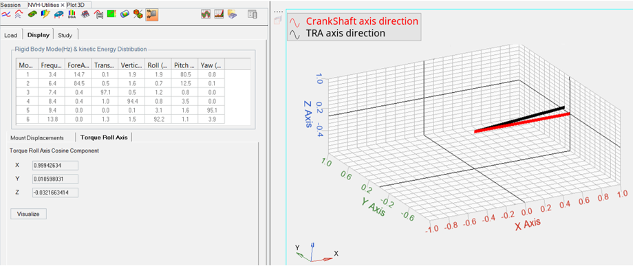

Torque Roll Axis
Plots the Torque Roll Axis with respected to the crankshaft axis direction.
Figure 1. Mount Optimization Utility - Display Tab - Torque Roll Axis Sub-tab

Predicts powertrain rigid body mode frequencies and kinetic energy distribution, which play a critical role in optimizing the mount stiffness and layout configuration, by decoupling powertrain rigid body modes and reducing vibration transmission.
Enter the powertrain and mounting configuration data manually or load the data from a configuration file.
Review rigid body mode frequencies and corresponding kinetic energy distribution.
Plot mount displacements in various static and dynamic loading conditions.
Perform sensitivity studies for mount position and stiffness. You can also perform an optimization setup to calculate the optimized mount stiffness and location layout for decoupling powertrain rigid body modes and frequency spacing.
