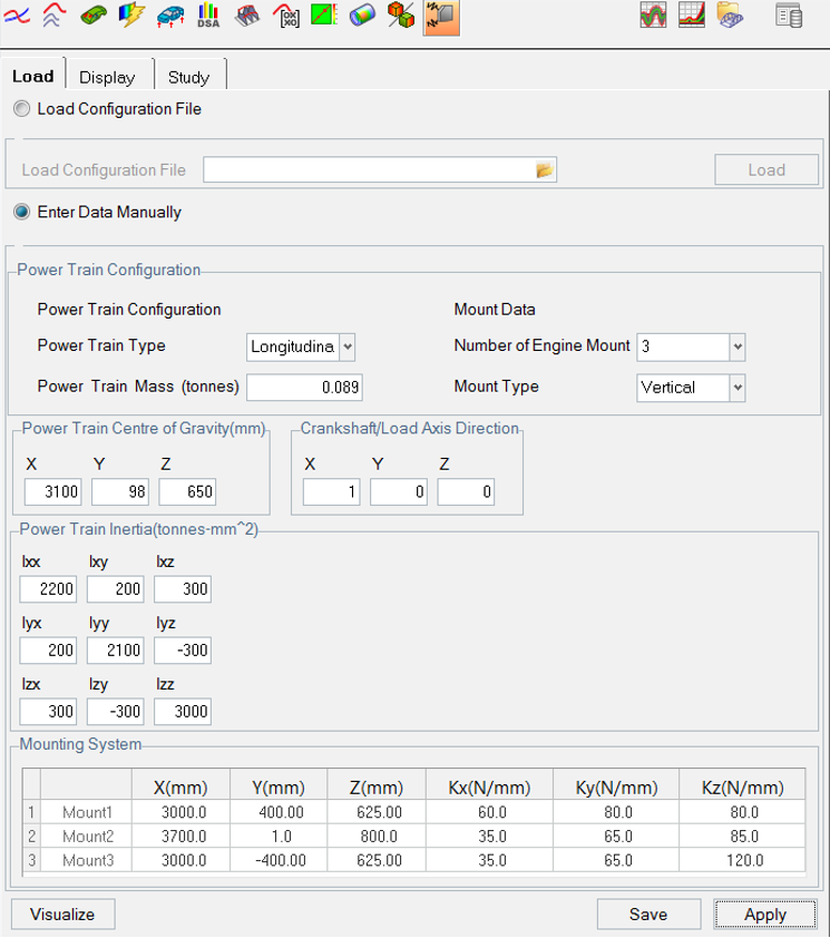

Mount Optimization - Load Tab
Enter the powertrain and mounting configuration data manually or load the data from a configuration file.
Figure 1. Mount Optimization Utility - Load Tab
