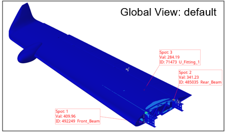

- Global View
- Shows all of the hotspots.
- Default
- Shows the entire model and all hotspots.

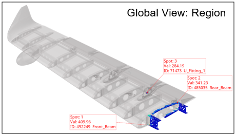

Figure 5. - Region
- Shows only the attached elements around all hotspots, rest of the model is
transparent.

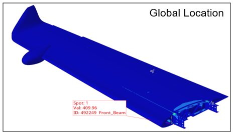

- Global Location
- Shows only one hotspot with entire model visible.

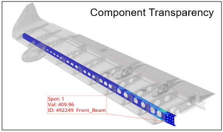

- Component Transparency
- Shows only one hotspot with its component and contour plot, the rest of the model is
transparent.

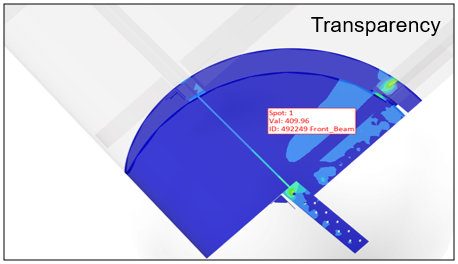

Figure 11. - Transparency
- Only the region (spherical) around the hotspot is shown, everything else in the
model is transparent.

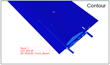

Figure 12. - Contour
- The hotspot is shown with the entire model contoured and zoomed into the
hotspot.
