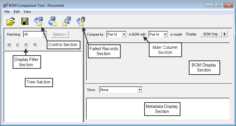

BOM Comparison Tool GUI
| Function | Description |
| Control section | Contains menu items and buttons to perform various operations. This section controls most tool functions. |
| Tree section | Contains a tree structure displaying part names and IDs. |
| Main column | Contains main column selection. |
| BOM display section | This section contains a table to display BOM info as it is seen in the actual BOM file. |
| Metadata display section | Contains options for metadata management. |
| Failed records section | Displays failed records from a loaded BOM file. |
| Display filter section | Contains filtering options for displaying tree and table info; part of the tree section. |
BOM Comparison Tool Control Section
This portion of the interface contains drop-down menus and the toolbar.

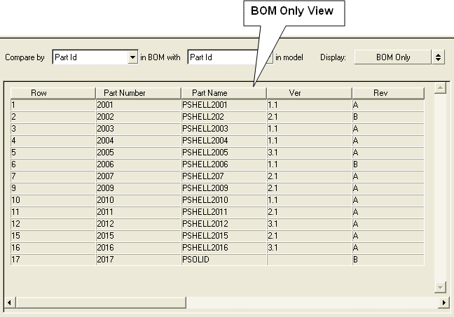

- Display section displays BOM info as it appears in the BOM file.

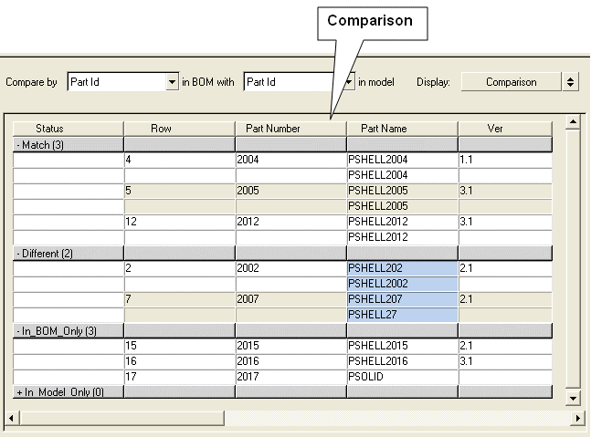

- Categorizes BOM information into four sections:
- Match: components in BOM whose standard attributes match exactly with those in the model.
- Different: components in BOM whose standard attributes differ from those in the model.
- In_BOM_Only: components found in BOM but not in model.
- In_Model_Only: components found in model but not in BOM.

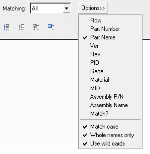

You can enter a string in the combo box, select the desired header in the options menu, and press RETURN to display the desired information in the tree and BOM display table. The combo box remembers previously entered strings until you quit the tool, and can be used to filter the BOM info anytime in the session.

BOM Comparison Tool BOM Display Section
BOM info displays in a table in the BOM display section, located in the center of the tool window just below the main column section. BOM info can be displayed in two different modes: BOM only and Comparison.

- Match
- BOM components whose standard attributes exactly match those in the model
- Different
- BOM components whose standard attributes differ from those in the model
- In_BOM_Only
- Components found in the BOM but not in the model
- In_Model_Only
- Components found in the model but not in the BOM
Figure 4. Comparison View
Column 1 shows the category name with the number of parts falling under that category enclosed in brackets; remaining columns display the BOM info. In the Different category, mismatched attributes between BOM and the model are highlighted in light blue.

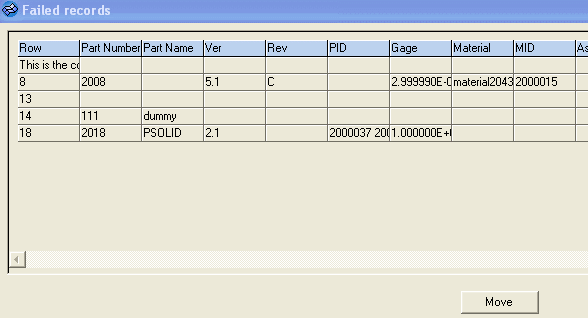

BOM Comparison Tool Failed Records Section
When a BOM file is loaded, the tool checks for the validity of each standard attribute in a record. A record corresponds to one line of information in the BOM file.
- Part Name
- Part ID
- Material
- Material ID
- Gauge
Figure 5. Failed Records
You have the option to edit each of those failed records to make them valid and move them to the BOM display table using the Move button.
