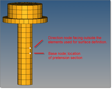

The tool then creates a surface (*SURFACE) cutting through the bolt at the location of the base node. It also creates a node in the surface plane, outside the bolt and not attached to the model. This node automatically gets an HM tag HMpre-tension_node so that it is easier to find.
If you want to use existing surfaces, pre-tension nodes or node sets, you need to disable the automatic surface and node generation setting and assemble each part of the pre-tension section manually.
