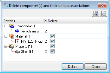

| Delete Advanced | Displays a comprehensive preview of the entities uniquely
related to the selected component that can also be
deleted. Only available for components in the LS-DYNA user profile.
![]() Figure 1. |

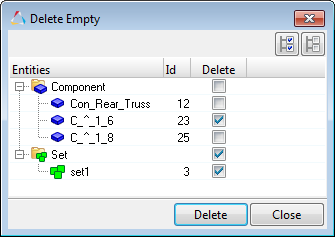

| Empty | Preview and delete empty collectors. This operation can be performed on several entity types at the same time. To append entity types to the selection, left-click while pressing Control. Only
available for the following entity types: Component, Load
Collector, System Collector, Set, Group, Assembly, Vector
Collector, Output Block, Load Step, Beam Section Collector,
Control Volume (OptiStruct) and
Multibody.
![]() Figure 2. |

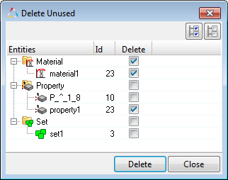

| Unused | Preview and delete unused property collectors, material
collectors, curves, and so on. This operation can be performed on several entity types at the same time. To append entity types to the selection, left-click while pressing Control. Only available for the
following entity types: System, Property, Curve,
Material.
![]() Figure 3. |
