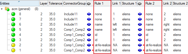

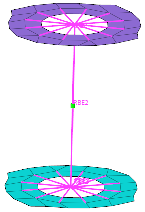

- Show Link Rule Columns
- When enabled, each link displays its reconnection rule (use ID, use
name, or at fe realize) via the Rule column. The reconnect rule is set
when the connector is created, and determines what the connector will
automatically try to reconnect with when a part is deleted and then
replaced.
- If the new part has the same part ID as the deleted one, then use ID will automatically reconnect.
- If the new part has the same name as the deleted one, then use name will automatically reconnect.

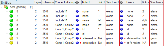

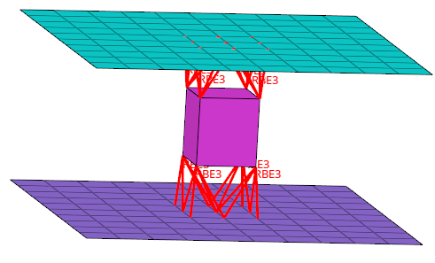

Figure 1. - Show Link Structure Columns
- When enabled, each link displays its link state (connect to mesh or
geometry) via the Structure column.
Figure 2. - Max Link Column Viewed
- Regardless of how many links a connector might have, the browser will only display the specified number of columns.

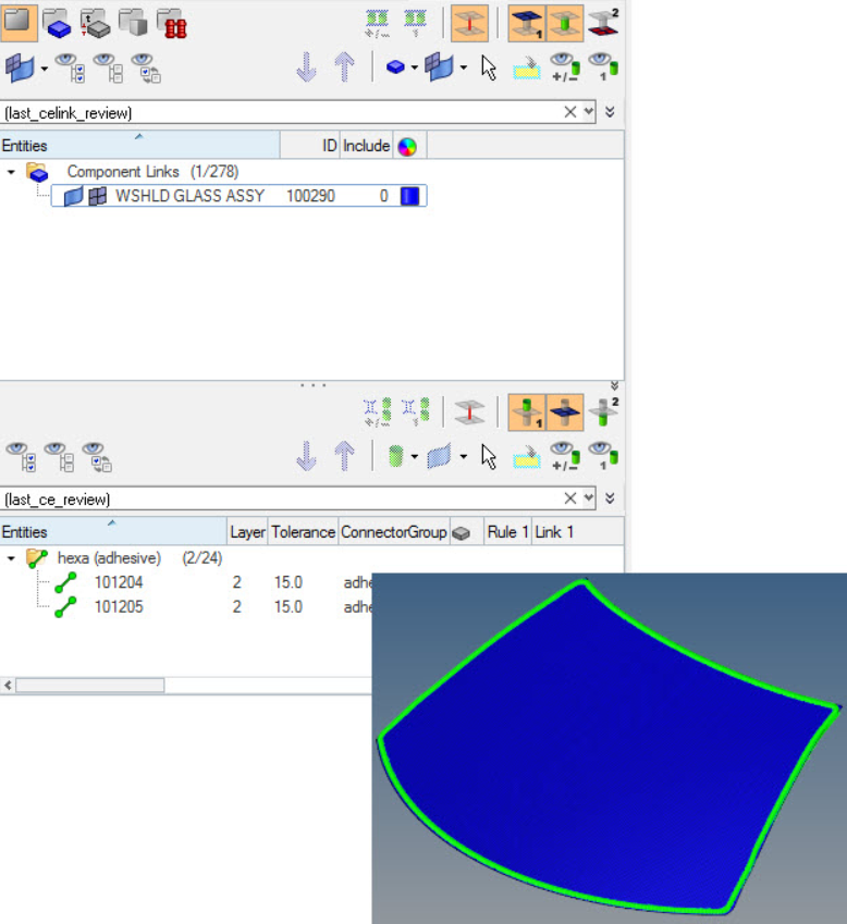

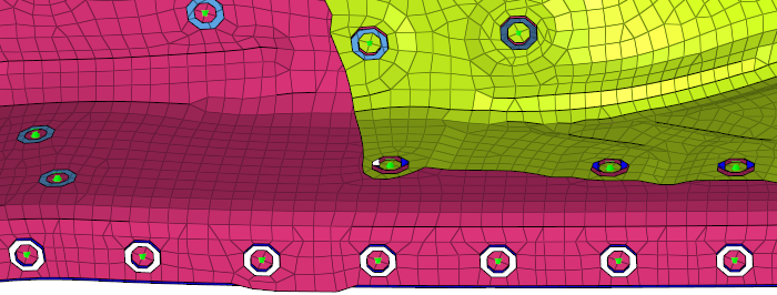

- Automatic Filter
- Filter the link entity list and the connector list simultaneously when
performing a show, isolate, or find operation.
Figure 3. Isolation of the Windshield Glass Components with Attached Connectors. The strings entered in the Query Builder (last_celink_review) and (last_ce_review) illustrate that the lists have been filtered. - Consider Geometry

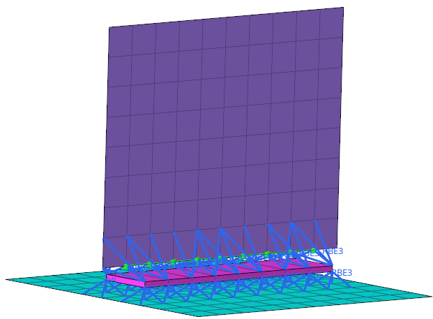

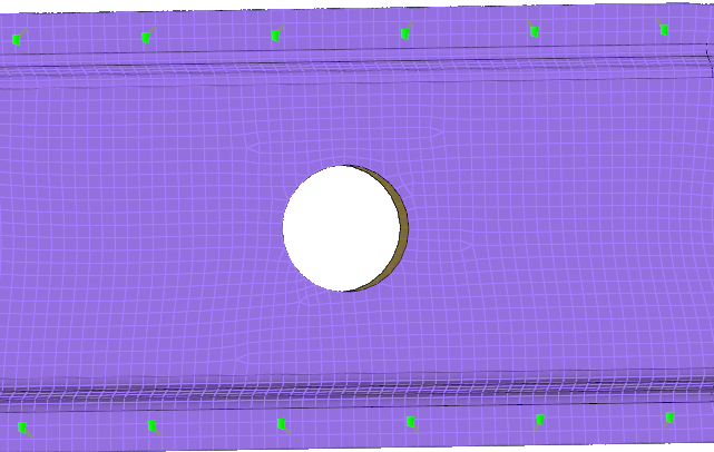

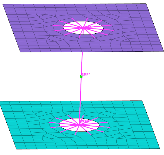

- Consider geometry along with elements while using Show/Hide/Isolate
operations.
Figure 5. Consider Geometry: Off
Figure 6. Consider Geometry: On - Consider HAZ Elements

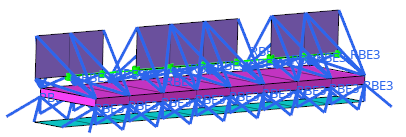

- Autofit
- Use this option in combination with the other view option toggle buttons
and show, hide, isolate, or isolate only, or in combination with the
advanced action buttons. After an action is performed, the newly found
connectors and/or entities are placed in the middle of the screen. If
this option is used in combination with one of the previously mentioned
buttons, it works like a pure fit view.
Figure 18. . In this example, the 1st connector and the link entity were Isolated with the fit view option. - Autocolor Visualization Mode
