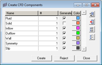

Create CFD Components

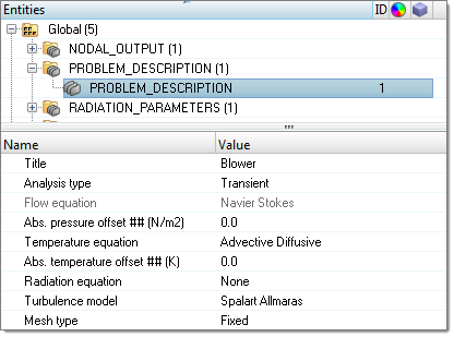

| Global | This folder is used to define problems and set solver parameters for that problem. It contains the following sub folders: Nodal Initial Condition, Problem Description, Radiation Parameters and Solver Settings. The Problem Description folder contains utilities to set up the analysis type and solver models. Use the Solver Settings folder to define parameters related to selected analysis types and solver models. Initial condition can be defined in the Nodal Initial Condition folder. The radiation parameters for the model can be defined in the Radiation Parameters folder. |

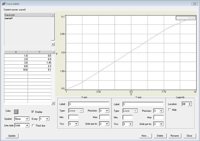

| Multiplier Function | Define multiplier functions to ramp up supported parameters. |

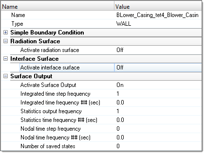

Figure 3.
Define Component Type/Properties

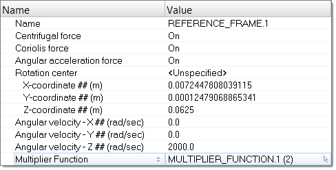

Create Reference Frame
This folder can be used to define reference frames.
