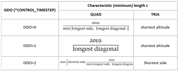

Critical Time Step for Shell (2d) Elements
Figure 3.

Characteristic length:
8 node solids:
4 node tetrahedras: Le = minimum altitude
