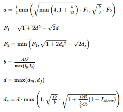

Critical Time Step for Beam (1D) Elements
Figure 6.
Figure 8.
