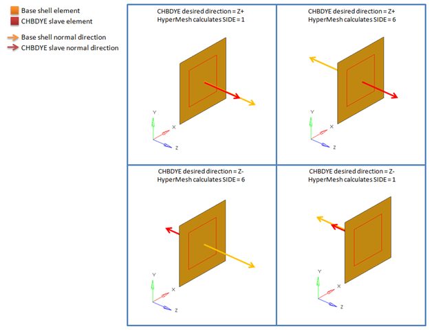

CHBDYE Side Conventions for 3D Elements
To automatically calculate the appropriate value of the SIDE parameter for newly created CHBDYE secondary on solid elements according to the specified face nodes and break angle, go to the Interfaces panel, Add subpanel, and set the secondary option to face.
CHBDYE Side Conventions for 2D Elements
For CHBDYE secondary on 2D shell elements, HyperMesh will automatically assign a SIDE parameter value of 1 (top) or 6 (bottom), depending on CHBDYE normal direction. Use the Normals panel (Tool page) to change CHBDYE normal direction.
Figure 1. Resulting SIDE Value for CHBDYE Secondary on 2D Shell Element

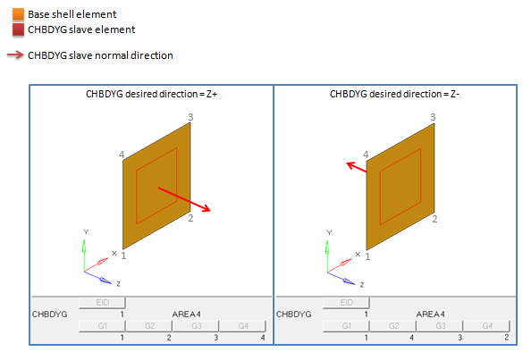

CHBDYG Side Conventions for 2D Elements
Figure 2. Resulting Node Order for CHBDYG Secondary on 2D Shell Element
