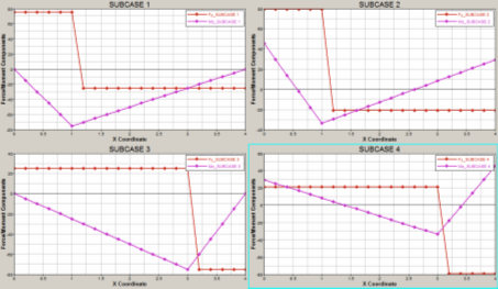

Figure 1. Sample output for X vs Fy and Mx for four subcases. The Envelop results option is unchecked. The Layout option is set to One plot per subcase.

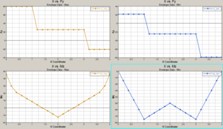

Figure 2. Sample output for X vs Fy and Mz for four subcases. The Envelop results option is enabled for both Maximum and Minimum. The Layout option is set to One curve per plot.
