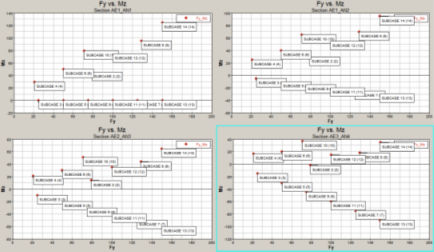

- X component and Y component
- Each plot is defined by selecting one X and one Y component and by clicking Add plot. Available X and Y components include Fx, Fy, Fz, Mx, My, Mz, Fr, and Mr. Any plots created are added to the table on the right.

- Plot points
- Currently, all interior and boundary points are plotted. Future releases will enable all options.
- Label points
- Allows you choose how to label each point in the plot. Options include:
- Label points (Name)
- Labels each point with the name of the subcase from which it's generated.
- Label points (ID)
- Labels each point with the ID of the subcase from which it's generated.
Note: If both options are selected, the format defaults Name (ID).
Figure 1. Sample output for Fy vs Mz for four cross-sections. Both the Label points (Name) and Label points (ID) options are selected.
