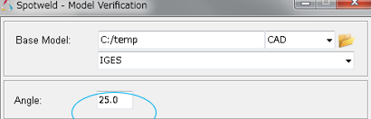

General Settings
- angle
- Feature angle of the faces of FE.

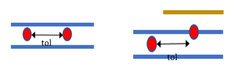

- Tolerance (tol)
- Distance between two spot welds less than/equal to this tolerance are
reported as duplicates. Distance is calculated after projecting to
normal direction.
Figure 3. - checktypes
- Allows searching duplicate spot welds on the same layer (same weld plates) or different layers or bots/all duplications.
Figure 4.

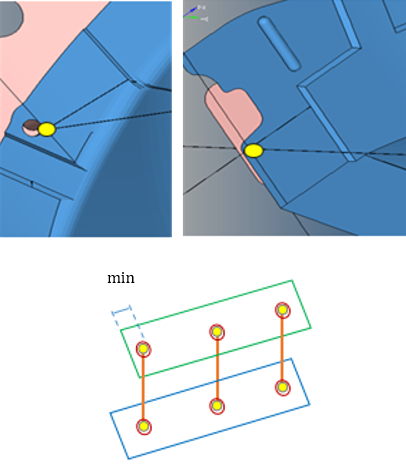

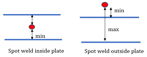

Gap
- do-check
- Turn OFF or ON the check
- min
- Minimum gap between Spot location and the weld plates.
Figure 5. - max
- Maximum gap to be considered between Spot location and the weld plates. This value is added to filter some spotwelds which are too far from the model.
Figure 6.

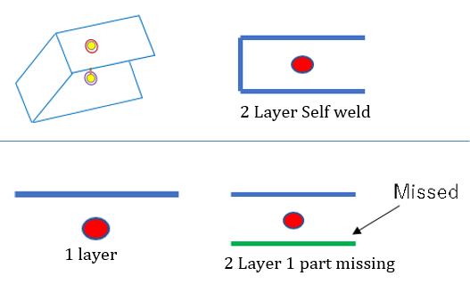

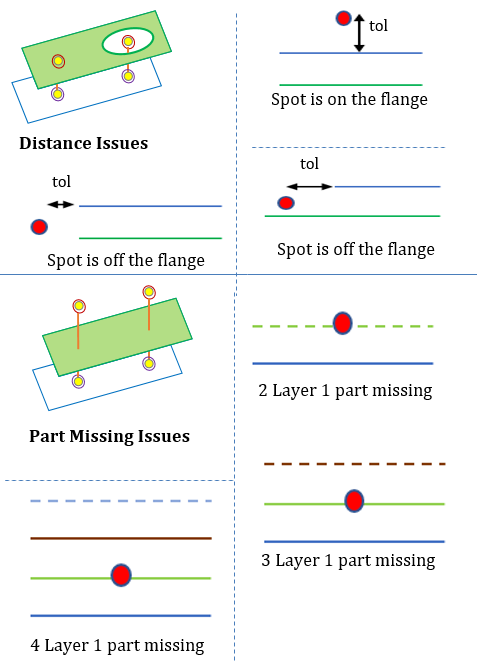

Single-Layer
- do-check
Figure 7.
Multi-Layer
- do-check
- threshold
- Maximum allowed spot weld layers.

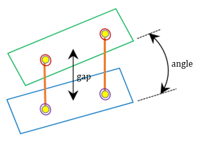

Parallel-flanges
- do-check
- angle
- Maximum angle between two plates at spot location.
Figure 10. - max-gap
- Maximum physical gap between two plates at Spot location.

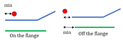

Incorrect-Location
- do-check
- min-distance (min)
- Minimum distance allowed from feature-line to the spot location.
Figure 12.
Figure 13.

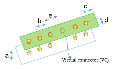

Few-Connections
- do-check
- Proximity (a)
- Search tolerance for realizing spot weld on the flanges, it is global pitch.
- pitch-spacing (b)
- Average pitch distance for creating spot weld on flange.
- pitch-offset (c)
- End offset distance on both side of the flange.
- pitch-edge-distance (d)
- Offset distance from the edge of the flange.
- search tolerance (e)
- Tolerance for searching Virtua connectors from existing connectors created from the above parameter.
- hole-diameter (f)
- Search tolerance for finding nearest Bolt holes to avoid finding the
issue.

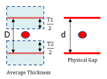

Flange-gap
- do-check
- limit
- +/- ratio of shortest gap between flanges at connector to average
component thickness value. It is also % of deviation.

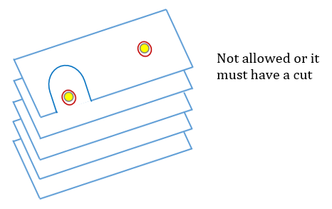

Intersection
- do-check
- spot-layers
- Maximum number of layers considered for this check.
Figure 18.
Figure 19.

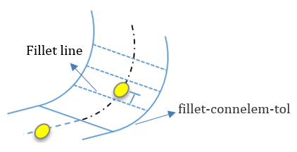

Fillets
- Fillet identification angle
Figure 20. - do-check
- fillet-connelem-tol
- Search tolerance for searching the nearest fillet edges to the
connector.
Figure 21.
Figure 22.

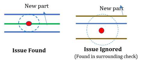

surrounding
- do-check
- spot-layers
Figure 25.
Figure 26.
