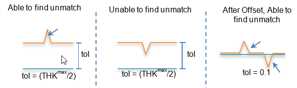

comparisonunified
Defaults for the offset functionality of Model Verification.
GUI Default Settings
- tolerance
- Search tolerance for searching nearest parts as well as search tolerance for
finding matching entities.
Figure 1. - threshold
- Cut off percentage for judging matched or unmatched parts. Too low of a value, such as 5%, is not recommended while checking a huge number of parts.

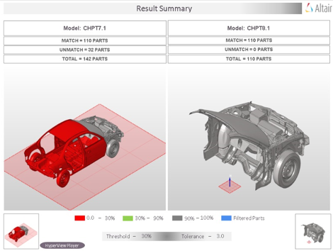

- scope
- Output result types.
- Matched
- 30.0 (threshold) to 100% matched parts
- Unmatched
- 0.0 to 30% matched parts
- Both
- 0.0 to 100% parts

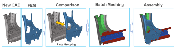

- mesh-unmatched
- After comparison for unmatched parts below, the process is automatically
executed.
- Group parts based on match% and report threshold%
- Execute BatchMesher
- Replace CAD with Batch Meshed FEs
- Assign material and property
- Load assembly (old + new mesh) import

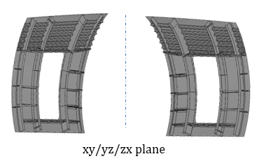

Figure 6. - symmetry
- Parts will be searched at the same location of the base part. If the
same shape part is not found variant part is reflected, then symmetry
comparison will be executed. Symmetry plane will be calculated by the
parameter below.
Figure 7. - symmetryPlane
- Plane to be considered for symmetryPlane comparison.

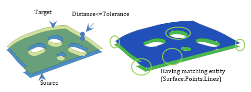

- Matched
- Occurs when a source or target surface is within the given tolerance of
a compared surface using a direct surface to surface comparison. All
points and lines comprising each surface must match between the
surfaces. Each matched surface is placed in a separate match type group
with the surface it matches.

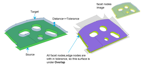

- Overlapped
- Occurs when all facet nodes of a source or target surface are within the
given tolerance of the compared surfaces and all of the facet nodes on
the nearest compared surfaces' exterior edges are within the given
tolerance of the source or target surface's exterior edges.

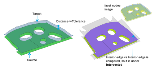

Figure 10. - Intersected
- Occurs when at least one but not all facet nodes on a source or target
surface are within the given tolerance of the compared surfaces or at
least one of the facet nodes on the nearest compared surfaces' exterior
edges is outside the given tolerance of the source or target surface's
exterior edges.
