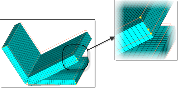

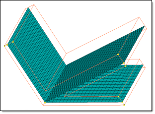

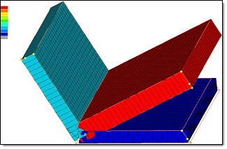

Figure 1. FE and Geometry with Traditional Element Visualization

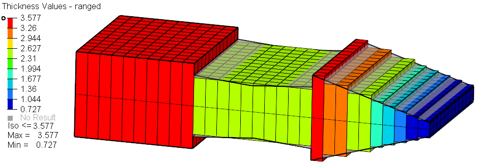

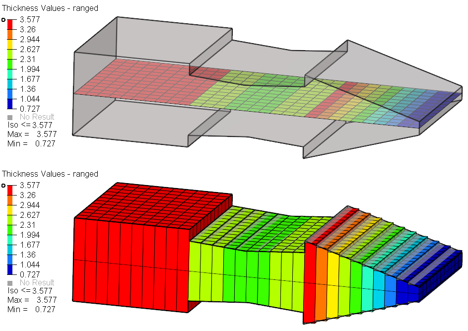

| Element coloring by thickness | Set the Element Color mode to By
Thickness resulting in a contour plot of thickness.![]() Figure 14. Thickness Contour Applied, 2D Detailed Element Representation |

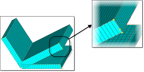

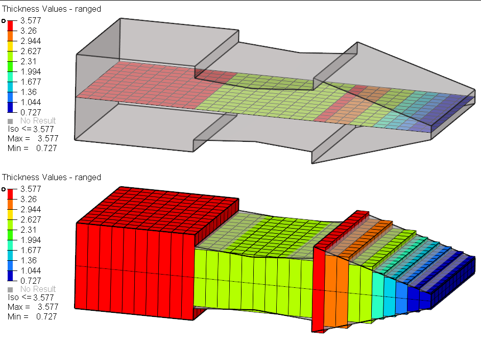

| 2D detailed element representation | Display midmesh elements as 2D with the assigned thickness as
depth.![]() Figure 15. 2D Detailed Element Representation The behavior of 2D Detailed Element
Representation depends on what you assigned a thickness to. For
example, if you assign a component an element thickness, then the
element thickness representation will be displayed. If you assign a
nodal thickness to an element node, then each individual node
thickness will be plotted and you will be able to see the first and
second order trias and quad elements. When you assign a nodal
thickness, you can select the By Thickness
option in the Visualization toolbar to display each node value. If
you assign a nodal thickness, and offset is on, then the element
thickness from the nodes will be calculated, the element will be
offset, and the nodal thickness 2D Detailed Element representation
on the offset elements will be plotted.
Restriction: Composites with variable thickness are not added for this
feature.

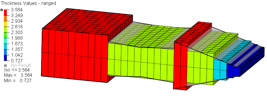

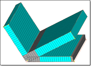

| Highlight corrected elements | Highlight the elements whereby the thickness could not be calculated
from solid, and deploy the correction method.![]() Figure 16. 2D Detailed Element Representation, Corrected Elements Highlighted |
