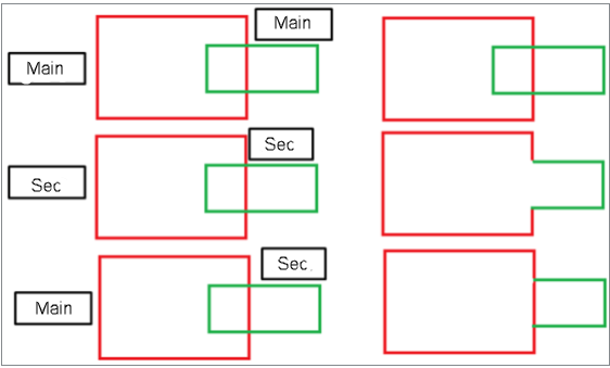

- Choose Union.

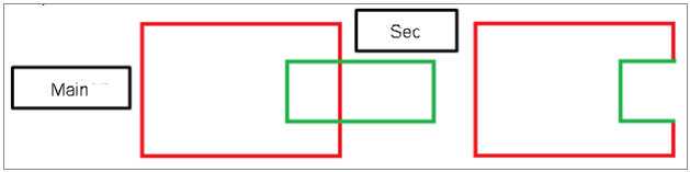

Figure 1. Union - Choose Subtract.
Figure 2. Subtract

Entities defined that are not present in main entities to preserve are considered as secondary. If you define all entities for boolean as main entities to preserve, entities will intersect and connect components but will not remove any internal shells. The boolean operation will only remove internal shells if they are enclosed and if they belong to an entity not defined as main entities to preserve. If both of these conditions are not satisfied the internal shells will not be removed.
- Use the main entities to preserve selector to select components that you do not want to remove internal shells for.
