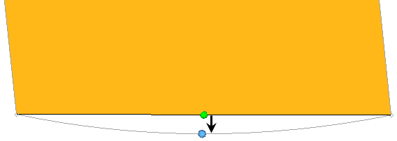

Chordal Deviation
Largest distance between the centers of element edges and the associated
surface.
Second order elements return the same chordal deviation as first order,
when the corner nodes are used due to the expensive nature of the
calculations. Figure 1. Chordal Deviation

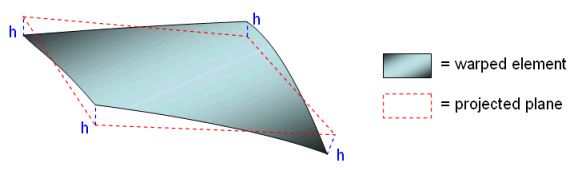

Warpage
Amount by which an element, or in the case of solid elements, an element
face, deviates from being planar. Since three points define a plane,
this check only applies to quads. The quad is divided into two trias
along its diagonal, and the angle between the trias’ normals is
measured.
Warpage of up to five degrees is generally acceptable. Figure 7. Warpage

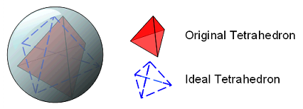

The shape factor for a tetrahedral element is determined by dividing the
element’s volume by the volume of an ideal (equilateral) tetrahedron of
the same circumradius. In the case of tetrahedral elements, the
circumradius is the radius of a sphere passing through the four vertices
of the tetrahedron. Figure 10.

Chordal Deviation
Chordal deviation of an element is calculated as the largest distance
between the centers of element edges and the associated surface. 2nd
order elements return the same chordal deviation as 1st order, when the
calculations. Figure 16. Chordal Deviation

Volume Skew
Only applicable to tetrahedral elements; all others are assigned values
of zero.
Volume Skew is defined as 1 minus the shape factor, so a skew of 0 is
perfect and a skew of 1 is the worst possible value.
of the tetrahedron. Figure 21. Volume Skew

Warping Factor
Only applicable to quadrilateral elements as well as the quadrilateral
faces of 3D bricks, wedges, and pyramids.
Calculated by creating a normal from the vector product of the element’s
two diagonals. Next, the element’s area is projected to a plane through
the average normal. Finally, the difference in height is measured
between each node of the original element and its corresponding node on
the projection. For flat elements, this is always zero, but for warped
elements one or more nodes will deviate from the plane. The greater the
difference, the more warped the element is. Figure 27.
The warping factor is calculated as the edge height difference divided
by the square root of the projected area.
