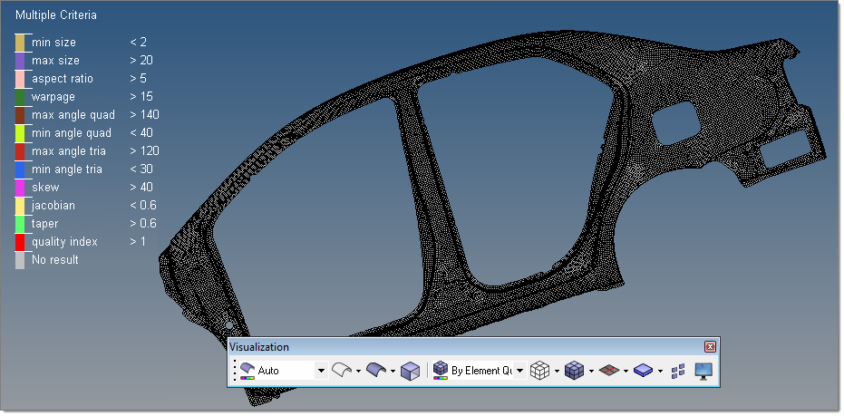

Element Quality View
The Element Quality view allows you to investigate each specific element criteria, view a breakdown of all failed and worst elements, resolve all criteria violations at one time, and evaluate the over all quality of a mesh.

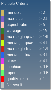

Multiple Criteria Legend
- Review the different 2D element criteria's.
- Adjust the initial threshold values assigned to each 2D element criteria.
- Select specific criteria's to investigate further.
When you click a criteria in the Multiple Criteria legend, a single criteria specific legend appears to the right of the threshold values. The elements are color coded according to how well they adhere to the quality requirements in the graphics area.

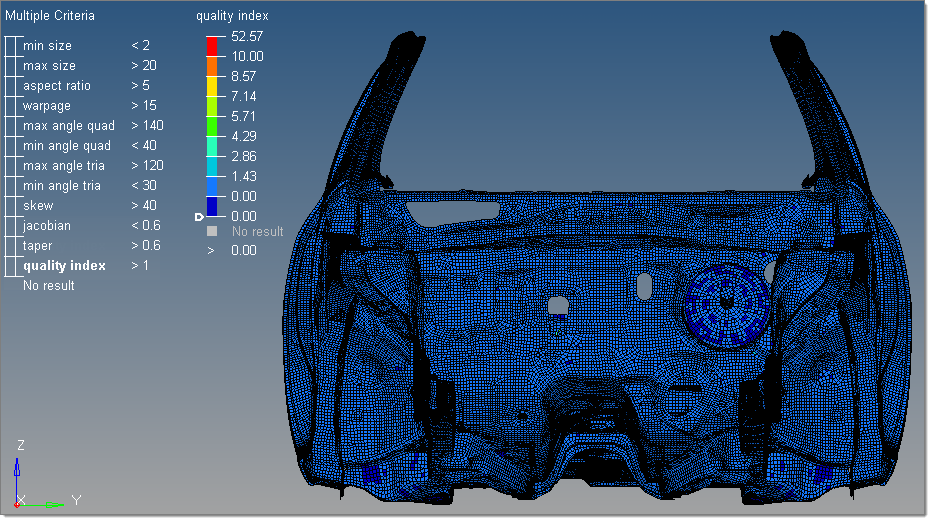

Single Criteria Legend
Figure 3.
Figure 4.
The Element Quality View tool always lists the values in the sliding scale from low to high, with the lowest value always being at the bottom of the scale and the highest value always being at the top. This tool always defines the first and last values in the legend with the minimum and maximum values. You cannot edit the minimum and maximum values.
The second and second to last values are the initial legend range coverage, based on the good to worst, warn to worst (default), fail to worst, and min to max values. These values are taken from the criteria file, and can be edited. The Element Quality View tool interpolates the values in between these.
Each single criteria legend contains a slider that is located, by default, at the exact, current threshold position. If the initial legend range coverage does not provide the threshold value set defined in the settings, then the slider will be positioned to the closest available value. To view a breakdown of all of the failed and worse elements, move the slider up and down.

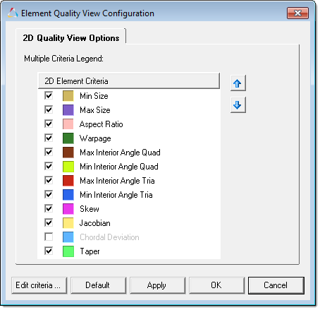

- Configure Quality View
Opens the Element Quality View Configuration dialog, from which you can:
- Change the color assigned to each criteria.
- Select which element criteria you would like to display in the Multiple Criteria legend.
- Rearrange the order of the element criteria in the Multiple Criteria legend
