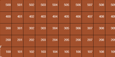

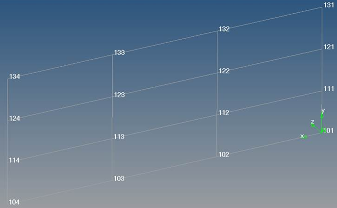

Renumber Based on Local System Direction
Using this method you will renumber the rectangular regular array of elements or quads in two perpendicular directions in a user defined coordinate system (Cartesian or cylindrical).
A local coordinate system must be created to match the two primary numbering directions.

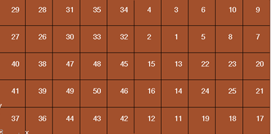

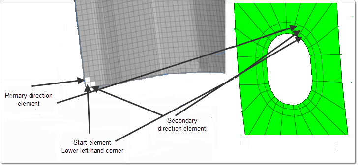

Renumber Based on Element Adjacency
The element and node renumbering option is based on element/node connectivity directions instead of local system directions.
Figure 3. Adjacency Based Renumber

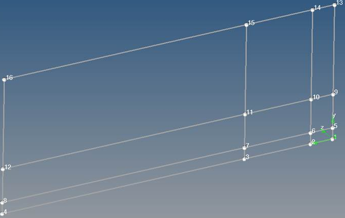

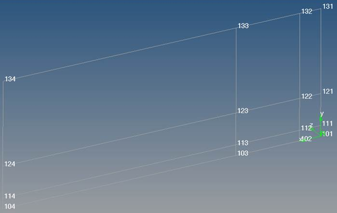

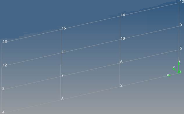

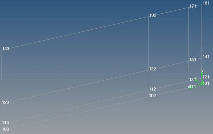

How the Tolerance Setting Affects the Renumber Result
The tolerance is used to group the nodes/elements in the correct order for renumbering.
