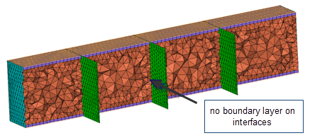

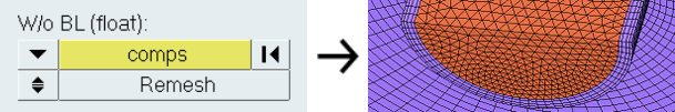

| W/o BL (fixed / float) | Select tria/quad
elements that define the boundary regions where a boundary layer
is not desired. The option W/o BL (fixed) can be used, for example, if two adjacent volumes are meshed sequentially and a matching interface has to be ensured. In that case the common interface elements have to be selected as W/o BL (fixed). |

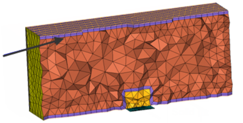

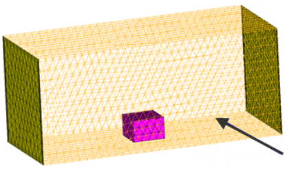

| Remesh/Morph |
![]() Figure 3. Starting Surface Mesh. The symmetry plane is blue, and the inlet area is dark yellow. ![]() Figure 4. Resulting Mesh, Morph Selected ![]() Figure 5. Resulting Mesh, Remesh Selected Note: Available when Smooth BL is selected.
| swap only / remesh | Choose a method for
managing the edges of the base 2D mesh in order to produce
better quality 3D tetra elements.

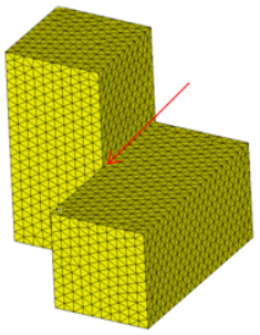

| fix comp borders | Maintain anchor nodes
during CFD tetrameshing, so that the new mesh must adhere to
them. You can also select 1D elements instead of nodes if you
need a tetra element edge at a certain location. Tip: Use this option when certain mesh nodes or edges
are required on a certain location, such as for
post-processing purposes.

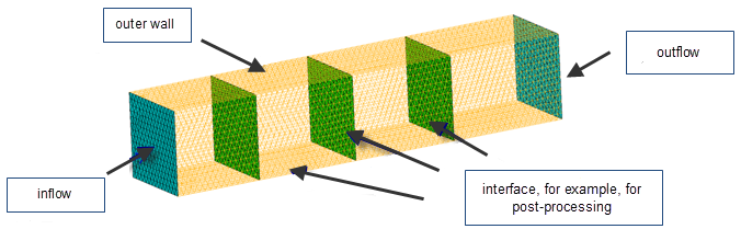

If the float option is chosen for some boundary regions, Engineering Solutions is allowed to swap surface shell edges during mesh generation. However, this prevents the swapping of edges between two components. ![]() Figure 6. Example: Fix Comp Borders |
| update input shells | Automatically update the shells on all boundaries after the meshing step. The updated shell elements will be placed in the initial boundary shell components. |

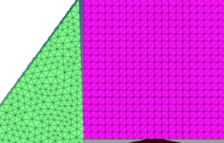

| fluid volumes selection | Specify fluid and solid volumes if multiple volumes exist.
The boundary layer will be grown only in the fluid volumes,
whereas the solid volumes are filled with a pure tetra mesh
without boundary layers. The use case is electronic cooling,
where you have several electronic components (solids) and
usually one large fluid domain.
![]() Figure 7. Solid (no BL) ![]() Figure 8. Fluid (with BL) ![]() Figure 9. BL Only in Fluid Domain |

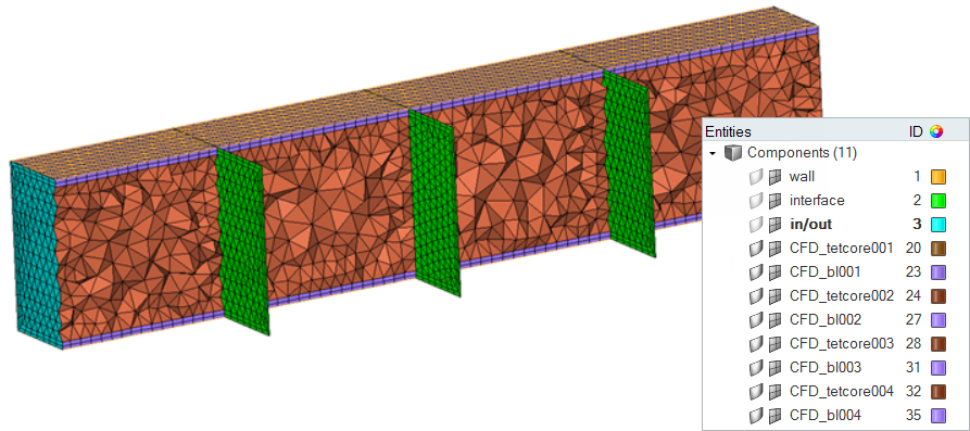

| comp per volume | Meshing multiple volumes with CFD Tetramesh will create two
components for each volume, one for the boundary layer elements
and one for the core (tetra) elements. For pure tetra meshing
only one component per volume will be generated. Enable this checkbox to generate several components. ![]() Figure 10. Example: Comp Per Volume |

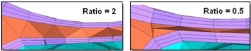

| BL hexa transition mode: Simple Pyramid | Use one pyramid element to transition from a BL hexahedral’s
quad face to the tetrahedral core mesh. The height of these
pyramids is controlled by simple transition ratio parameter,
which represents the ratio between the transition pyramid height
and the characteristic size of the base quad. Note: Available
| BL hexa transition mode: Smooth Pyramid | Generate a transition layer composed of pyramid and
tetrahedral elements. The thickness of this layer is controlled
by the parameter smooth transition ratio, which represents the
ratio between the transition layer thickness and the
characteristic size of the base quads. Note: Available when

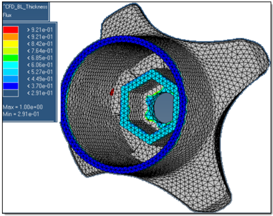

| BL reduction | Define the parameters for scaling the boundary layer
thicknesses to avoid narrow or closed channels. Several BL
reduction mechanisms are available, and can be combined with
each other.

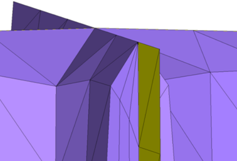

| Sharp edges handling |
| Min imprint angle from BL to non-BL | Control which cases
you want to imprint BL on without BL components. If the angle
between the BL component and the non BL component is really high
imprinting will create high aspect ratio elements. If the angle
between BL and No-BL entities (component elements) is less than
the imprint angle or greater than (180-imprint angle) it will
collapse the BL, rather than imprint on non-BL entities. Important: Recommended range is
6-10.
Note: Available when Smooth/Truncate BL is
selected.

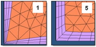

| Max layer diff between neighbor elems | Control the maximum
layer difference between neighboring elements. This helps to
avoid a situation where all BLs collapse at once. This parameter
also provides smooth BL transition in case of BL truncation. One
fourth of the total BL layers is a good number for this
parameter. It also depends on layer height. Important: Recommended range depends on how many
layers you are growing.
![]() Figure 23. Max Layer Diff Between Neighbor Elems = 2. Two layers are collapsed at a time when required. Note: Available when Smooth/Truncate BL is

| Pyramid transition ratio | Specify the relative height of pyramid elements used for the transition from hexa elements in the boundary layer to the tetra elements in the core. |
