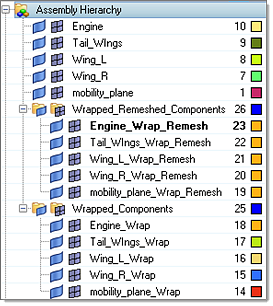

- Organize wrap elements by base comps
- If this option is activated, the wrapped elements will split so that they are organized based on input components. Duplicate naming is not allowed, therefore the wrapped components will be named the original component name followed by _Wrap. If the Remesh with growth rate option is not activated, a component called Adaptive Wrapper will be created. If the Remesh with growth rate option is activated another component will be created called Adaptive Wrapper_Remesh.
- Remesh with growth rate
- This option will remesh the entire wrapped component with defined growth rate. The element size for remeshing will be automatically detected. If this option is selected along with the organize wrap elements by base comps option, then the wrapped components will be remeshed and named as the original component name followed by _Wrap_Remesh. Separate assemblies will be created for wrapped and remeshed components, as shown below.
