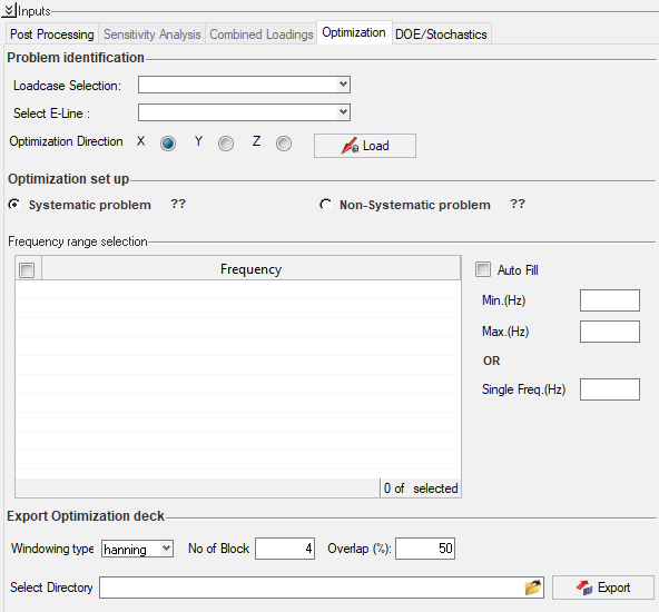

Optimization Deck setup
Once the optimization deck setup is initiateed, following changes are done to the solver deck:
- Load case setup : Modal Transient (MTRAN) analysis is changed to Modal Frequency Response (MFREQ)
- Optimization parameters set-up: Responses and ConstraintsNote: Frequency range selection table will be empty for a Static Load case setup work flow.
Optimization Deck setup process
- Select interface with Squeak and/or Rattle issue.
- Load the interface to understand the critical frequencies
Figure 2. - Select direction for Optimization.Note: This selection must be based on the information shown in the Relative Displacement or Line graph.
- Identify frequency or frequencies to optimize.
- Select the Auto Fill option to automatically fill the frequency (Top Contributing mode from RMC Bar Chart) or frequencies of selected modes.
- Click file browser icon for Choose Directory option.
- Click Export button.
