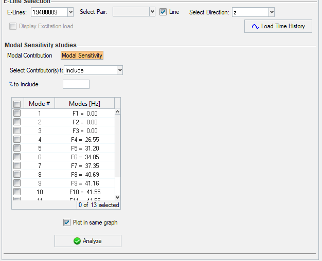

To do a modal sensitivity study, you have to select the Modal Sensistivity button in Modal Sensitivity studies tab.
- Select Contributor(s) to - drop down list to select
whether to Include or Exclude a mode for analysis
Figure 2.Input Description Inlcude Includes the selected modes in the recalculation of the displacements Exclude Excludes the selected modes in the recalculation of the displacements - % to include - to define the percentage value of the mode to be considered for evaluation
- Modes - list containing all the modes present in the
result file. You can check the boxes under
Modescolumn to select a mode - Plot in same graph - check box to define if the study plot should be plotted in the same graph as the relative displacement
- Analyze - after making the required inputs definition, click to run the analysis and plot the graphs.
