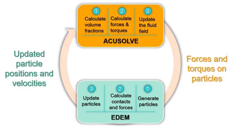

This tutorial introduces you to the workflow for setting up and running a basic bidirectional coupling (two-way) simulation using AcuSolve and EDEM. Prior to starting this tutorial, you should have already run through the introductory HyperWorks tutorial, ACU-T: 1000 Basic Flow Set Up, and ACU-T: 6100 Particle Separation in a Windshifter using Altair EDEM, and have a basic understanding of HyperWorks CFD, AcuSolve, and EDEM. To run this simulation, you will need access to a licensed version of HyperWorks CFD, AcuSolve, and EDEM.

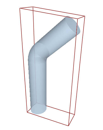

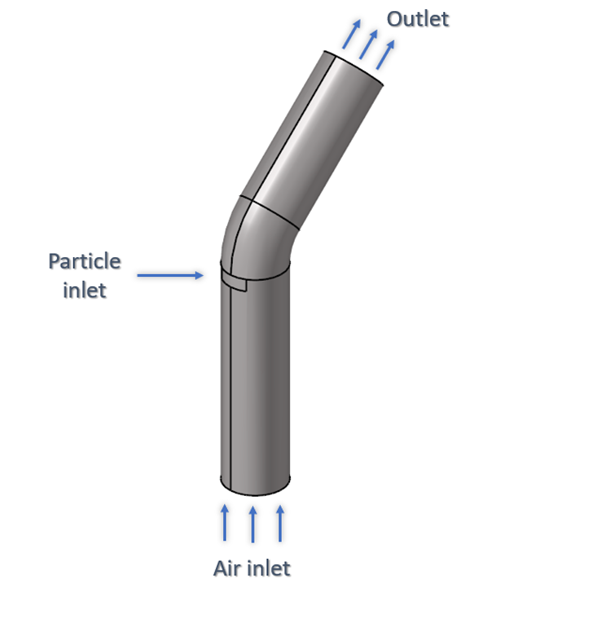

The model consists of a cylindrical pipe with a 45-degree bend. The radius of the pipe is 0.25 m and the particle inlet is located midway through the length of the pipe.

The AcuSolve model will be set up using HyperWorks CFD. Once the AcuSolve setup is complete, the EDEM deck with the geometry will be exported from HyperWorks CFD. This input deck will be opened in EDEM and will be used to complete the EDEM setup. Once the EDEM deck is set up, you will launch the coupled simulation.

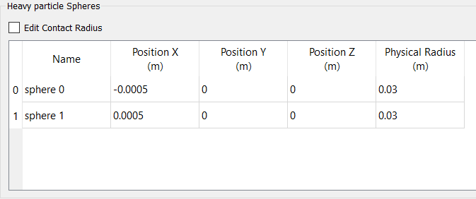

Two different bulk materials used in the EDEM simulation and their properties are listed below:
| Name | Density (kg/m3) | Size of particle (m) | Average weight of individual particle (kg) | Rate of generation (particles per sec) |
| Heavy particle | 900 | 0.03 | 0.1 | 100 |
| Light particle | 100 | 0.03 | 0.01 | 100 |

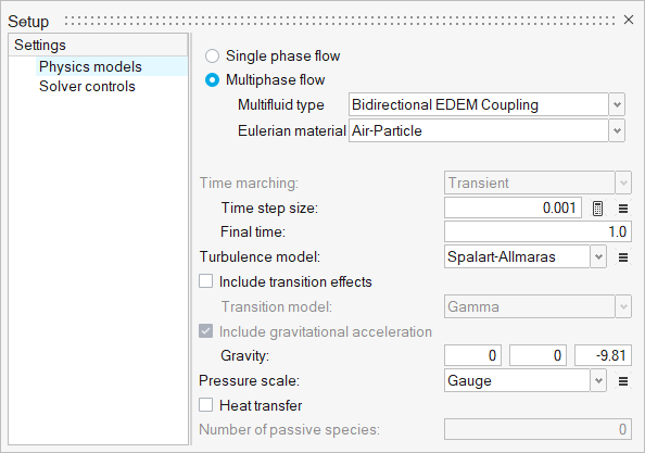

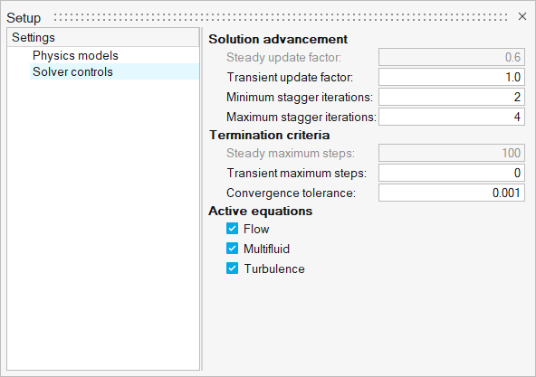

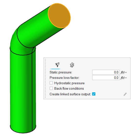

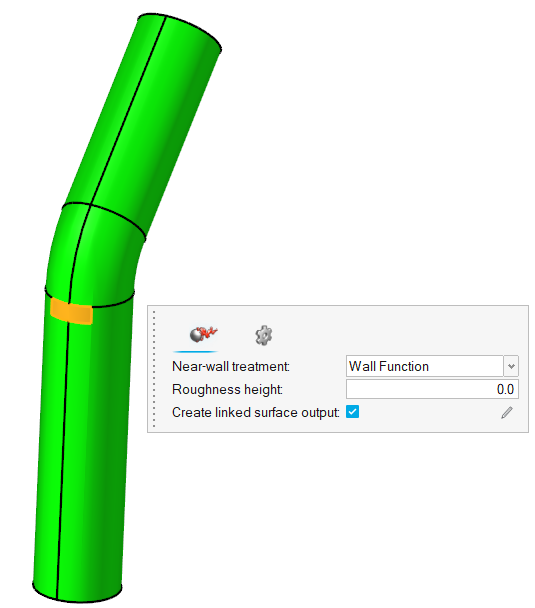

Set Up Flow

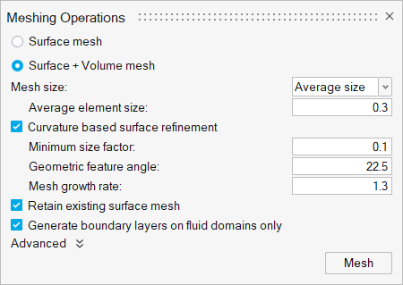

Generate the Mesh

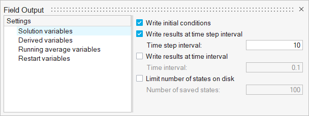

Define Nodal Outputs
Once the meshing is complete, you are automatically taken to the Solution ribbon.

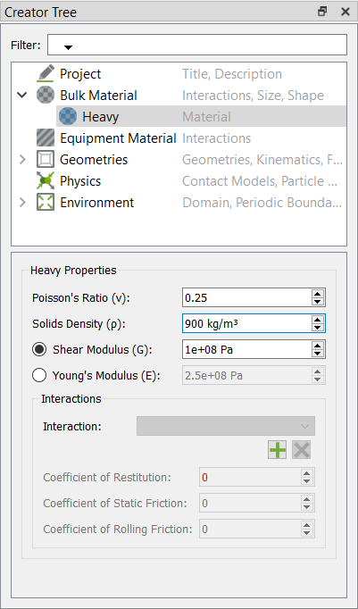

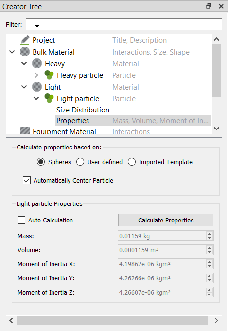

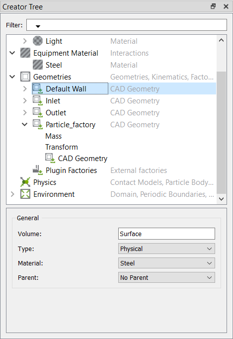

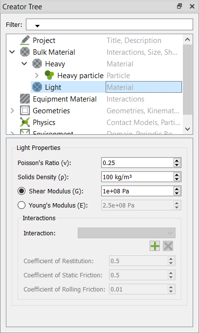

Define the Bulk Materials and Equipment Material
In this step, you will define the material models for the heavy and light bulk material and the equipment material.

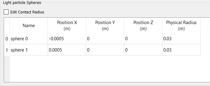

Create the Particle Factory
Define the Particle Factory
Now that the bulk material, geometry sections, and equipment materials are defined, you need to create a particle factory to generate the particles. You will create one factory for each bulk material.

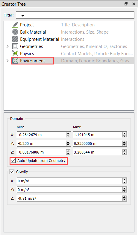

Define the Environment
In this step, you will define the extents of the domain for the EDEM simulation and the direction of gravitational acceleration.

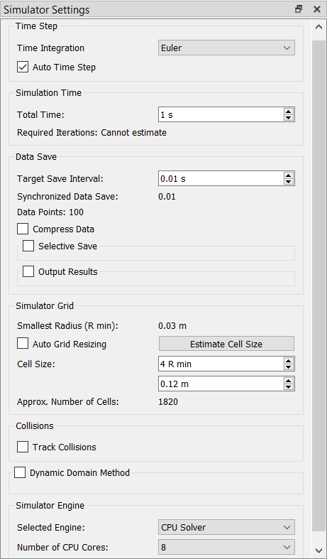

Define the Simulation Settings

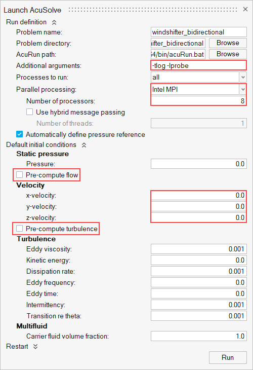

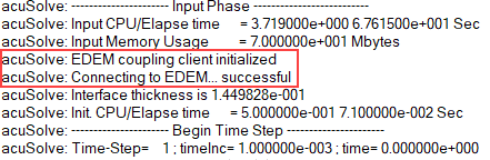

Submit the Coupled Simulation

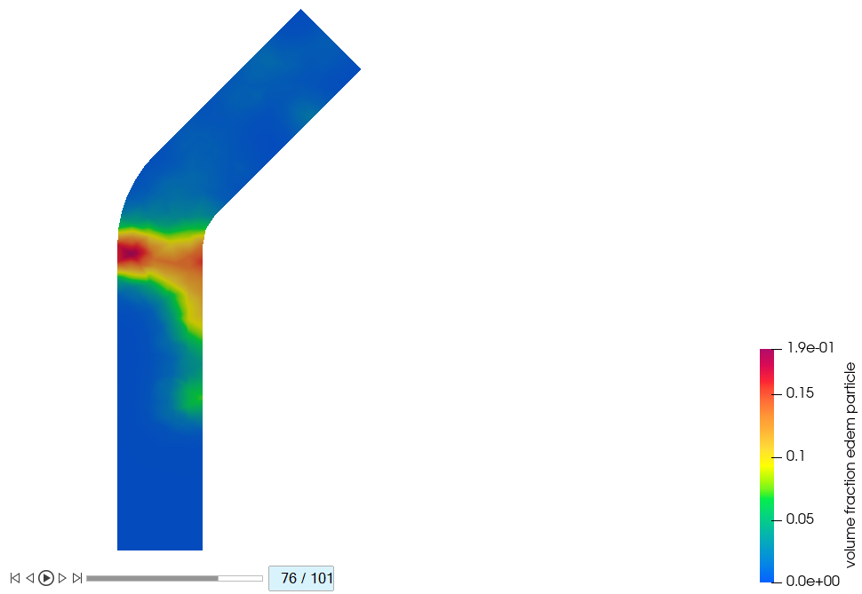

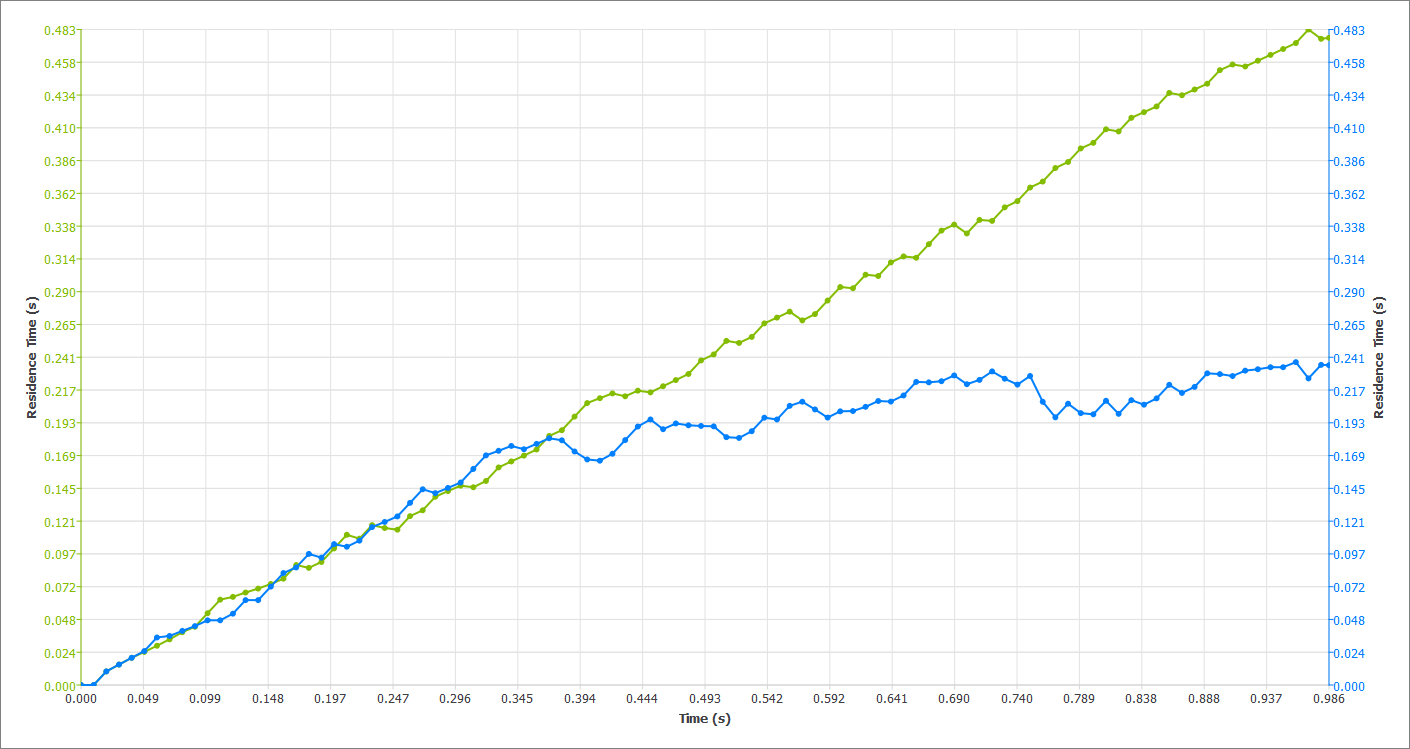

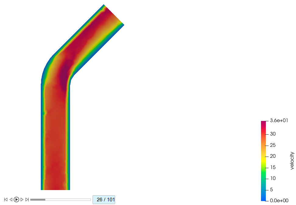

Analyze the Results

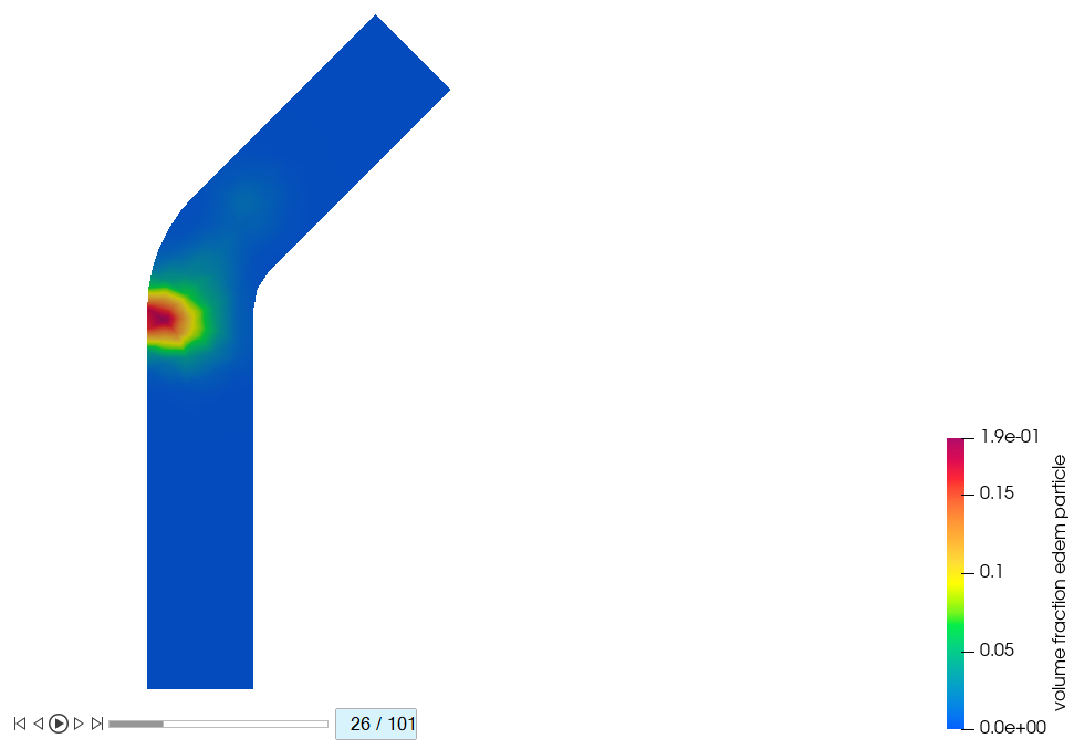

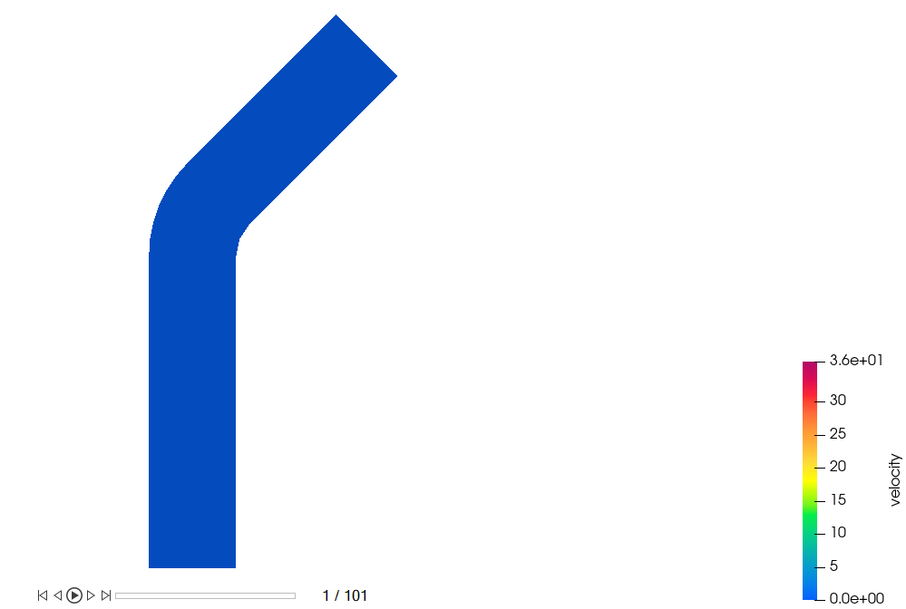

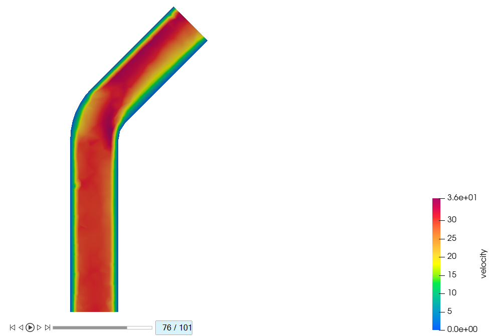

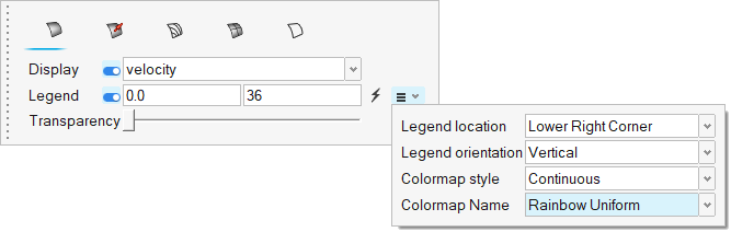

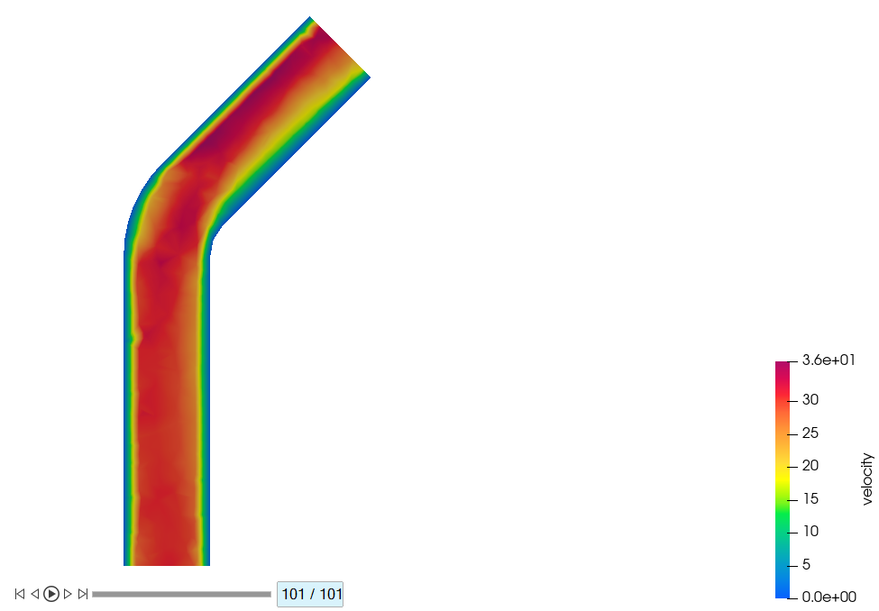

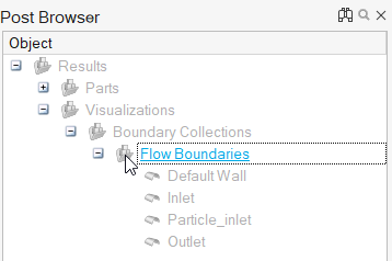

AcuSolve Post-Processing

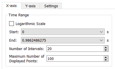

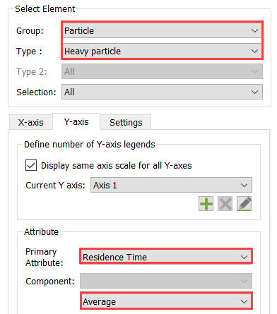

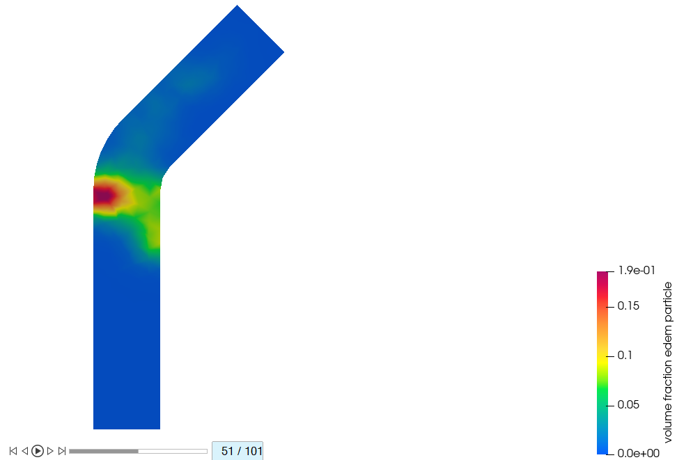

EDEM Post-Processing
