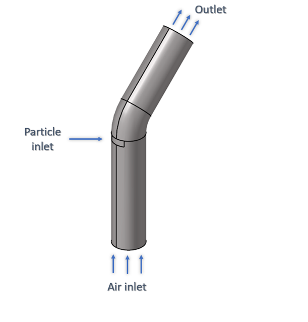

The model consists of a cylindrical pipe with a 45-degree bend. The radius of the pipe is 0.25 m and the particle inlet is located midway through the length of the pipe.

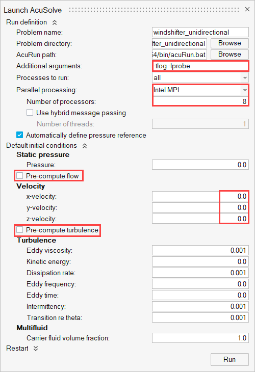

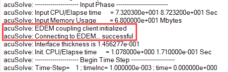

Submit the Coupled Simulation

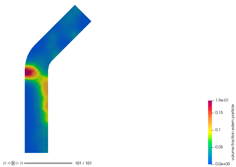

Analyze the Results
AcuSolve Post-Processing

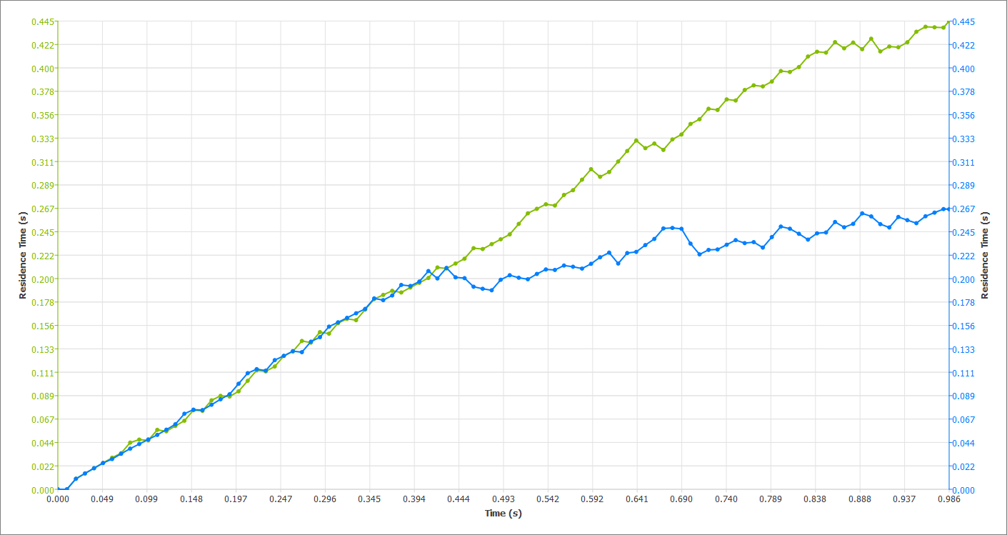

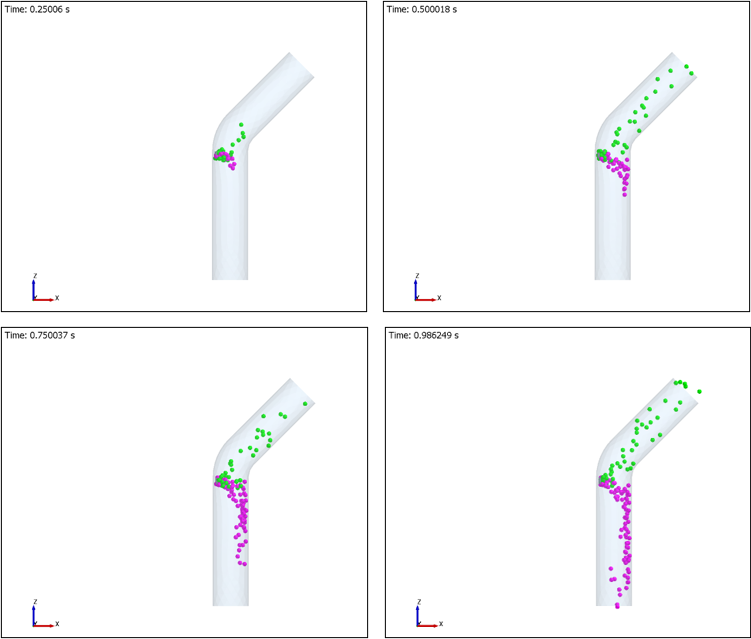

EDEM Post-Processing

In this tutorial, you learned how to setup and run a basic AcuSolve-EDEM unidirectional (one-way transient) coupling problem. In the first part, you set up the AcuSolve model in HyperWorks CFD and exported the geometry. Next, you imported the EDEM input files created by HyperWorks CFD, set up the EDEM model, and ran the coupled simulation. Once the coupled simulation was completed, you learned how to create animations and plots in both HyperWorks CFD Post and EDEM Analyst.
