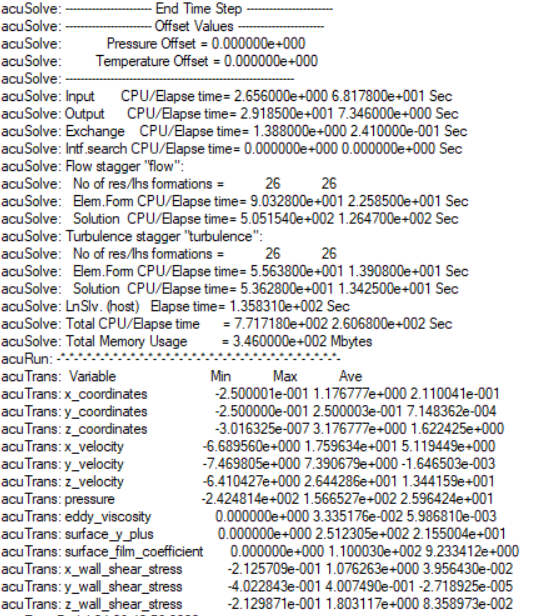

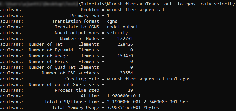

The setup for the AcuSolve simulation is done using HyperWorks CFD. Once the AcuSolve simulation is complete, the velocity nodal data is exported into CGNS format using the AcuTrans utility available in AcuSolve. This field data will be imported into EDEM and will be used to calculate the drag forces on the particles due to the fluid.

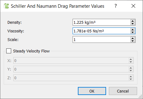

The fluid drag forces on the particles are calculated using the Schiller-Naumann drag model. The drag force on the particle is calculated using the relative velocity of the particle with respect to the local fluid velocity. This particle body force will used to update the location of the particles and then the new drag forces are calculated. This loop is repeated until the end of the simulation.

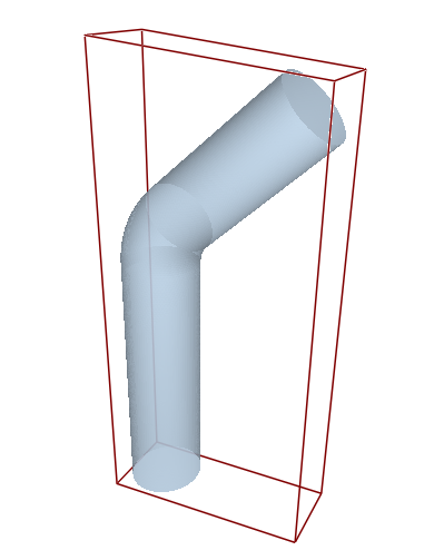

Validate the Geometry

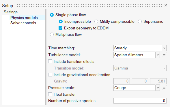

Set Up Flow

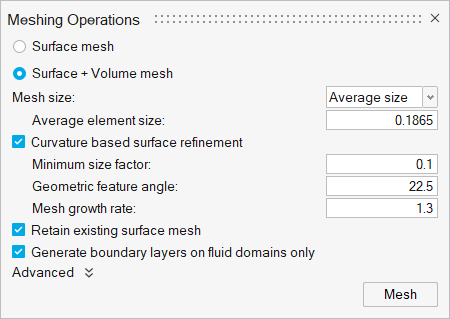

Generate the Mesh

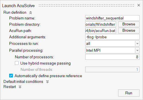

Run AcuSolve
Export Velocity Field Data
As the solution progresses, the AcuTail and AcuProbe windows are launched automatically.
In the AcuTail window, the residual ratio and solution ratio information is printed as the simulation progresses.

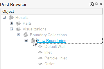

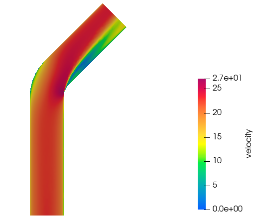

Post-Process the Results with HW-CFD Post

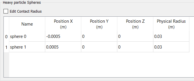

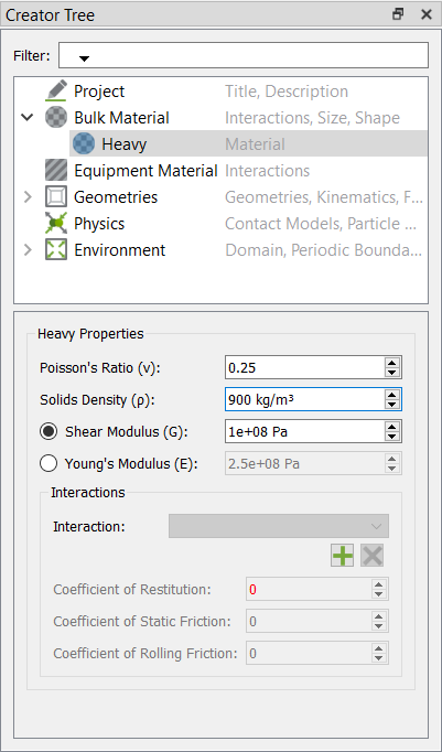

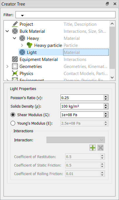

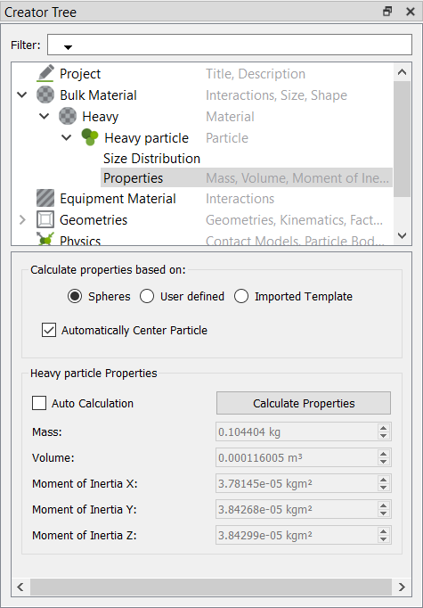

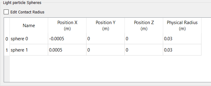

Define the Bulk Materials and Equipment Material
In this step, you will define the material models for the heavy and light bulk material and the equipment material.

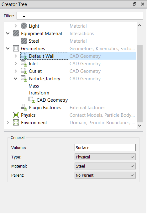

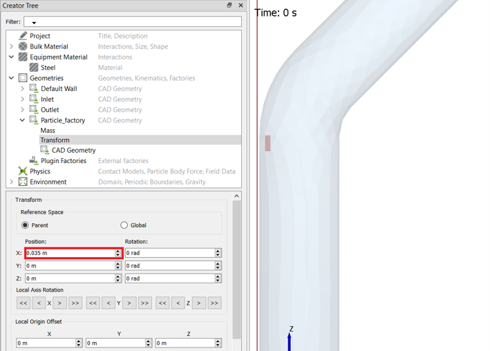

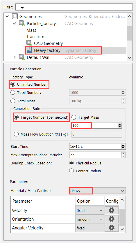

Create the Particle Factory
Define the Particle Factory
Now that the bulk material, geometry sections, and equipment materials are defined, you need to create a particle factory to generate the particles. You will create one factory for each bulk material.

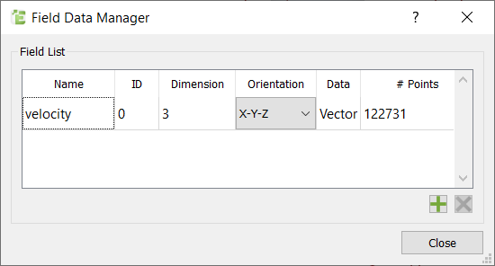

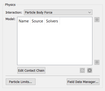

Define the Physics and Import CFD Field Data
In this step, you will define the physics models for particle collisions and the particle body force.

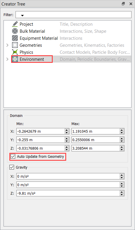

Define the Environment
In this step, you will define the extents of the domain for the EDEM simulation and the direction of gravitational acceleration.

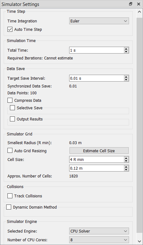

Define the Simulation Settings and Run the Simulation

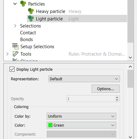

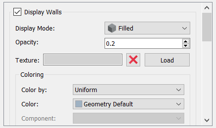

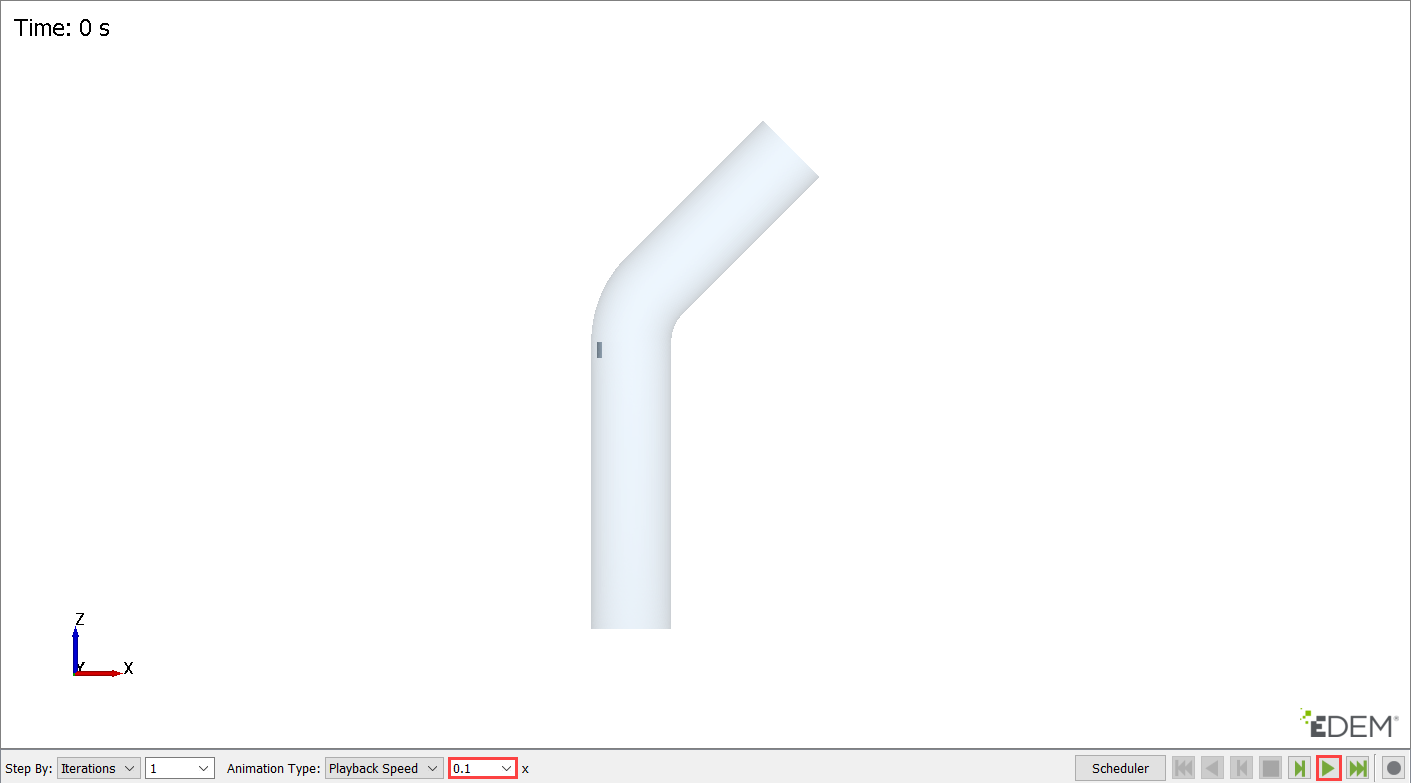

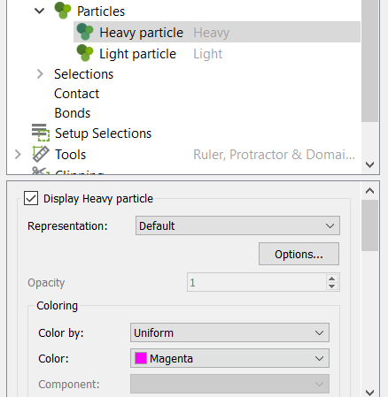

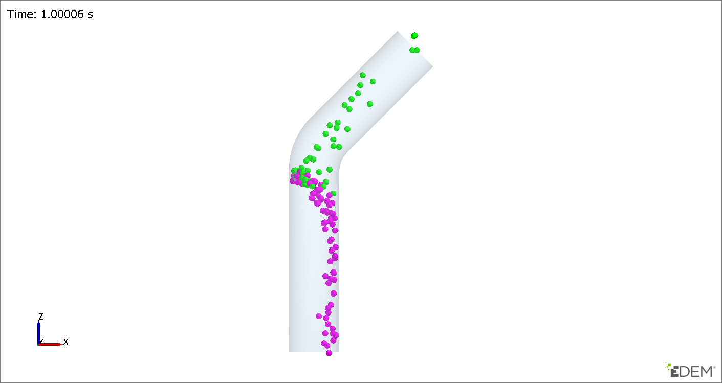

Analyze the Results

In tutorial you learned how to setup a basic AcuSolve-EDEM sequential (one-way steady) coupling problem. In the first part, you set up and solved a steady state flow simulation using AcuSolve and then exported the CFD field data using AcuTrans. Next, you set up the EDEM model and imported the CFD field data using the Field Data Manager. Once the EDEM simulation was completed, you learned how to view results and create animations in EDEM Analyst.
