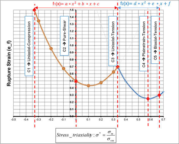

  1. This failure criteria is defined using failure plastic strain versus stress triaxiality (state of stress). This allows for the different plastic failure strains that materials exhibit depending on loading condition. The curve is described by 2 parabolic functions that intersect at the triaxiality value of 1 3 which is uniaxial tension.
    The parameters for the 2 parabolic failure strain curves versus the state of stress (stress triaxiality) are calculated iteratively by Radioss during the initialization phase using the input c1-c5 values. The calculated parabolic failure curve parameters a, b, c, d, e and f, can be reviewed in the starter output file.
    If the calculated parabolic failure strain curves have negative failure strain values, these negative values will be replaced by a failure strain of 1E-6 which results in a very high damage accumulation and brittle behavior.

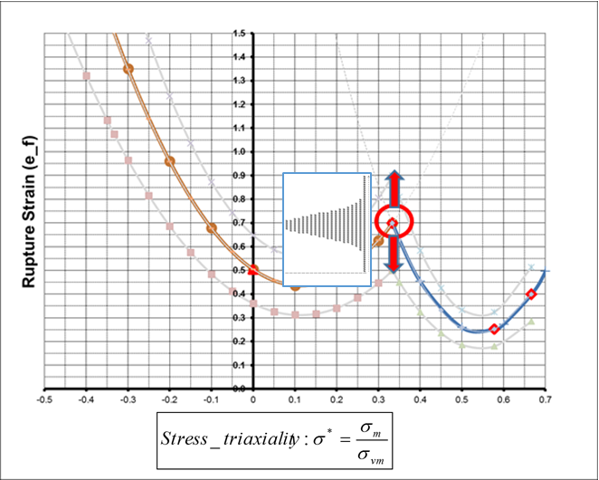

  6. If /PERTURB/FAIL/BIQUAD is used, M-Flag > 0 must be used and the scatter will be applied to the c3 value only. The resulting c1, c2, c4, and c5 values will be calculated using the failure strain ratios thus applying the perturbation noise to the entire failure strain curve.
