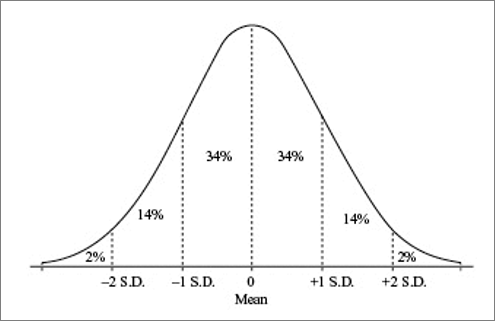

- If Idistri = 1, the distribution of the scale factors will be
random.If Idistri = 2, the normal distribution of the scale factors will have the following probability density function.
Figure 1. - This option is only available for shell elements.
