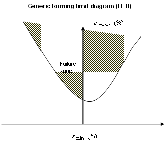

/FAIL/FLD
Block Format Keyword Describes the forming limit.
Format

/FAIL/FLD/4/1
# Func_id Ifail_sh I_marg Fct_ID_adv R_ani Dadv Istrain Ixfem
1012 1 0 0 0 0 0 0
/FUNCT/1012
FLD diagram
# X Y
-0.7 0.90
-0.4 0.60
-0.3 0.50
-0.2 0.40
-0.15 0.35
-0.1 0.30
-0.05 0.29
-0.03 0.28
0.0 0.28
0.05 0.33
0.1 0.36
0.2 0.39
0.3 0.42
0.4 0.45
#enddata
