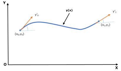

Figure 1. Euler–Bernoulli beam elementDisplacement field, y(x) = s1(x)y0+ s2(x)y’0 +s3(x)y1+ s4(x)y’1
- s1 to s4 are shape functions of beam.
- x0, y0, x1, and y1 are nodal coordinates of 2 grids.
- y’0 and y’1 are slope coordinates (gradients) at 2 grids.
