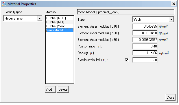

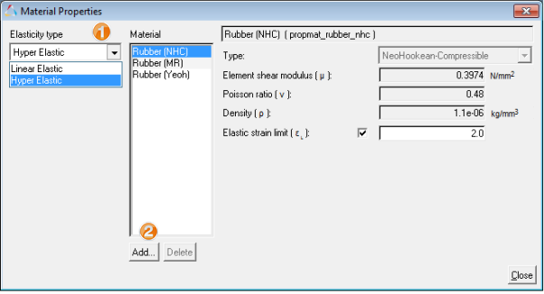

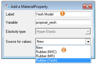

Add a New Material Property
In this step, you will add a new material property.

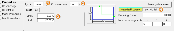

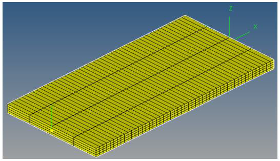

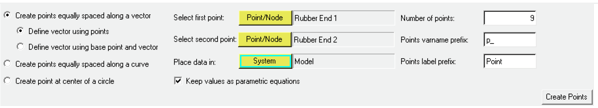

Model the Rubber Strip
In this step, you will model the rubber strip for the tensile test.

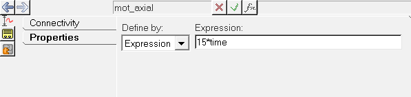

Add Constraints
In this step, you will create constraints for the rubber strip model.

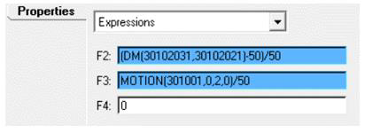

Add Outputs
Now you will create outputs to measure engineering strain and engineering stress values.
Engineering Strain =
Engineering Stress =

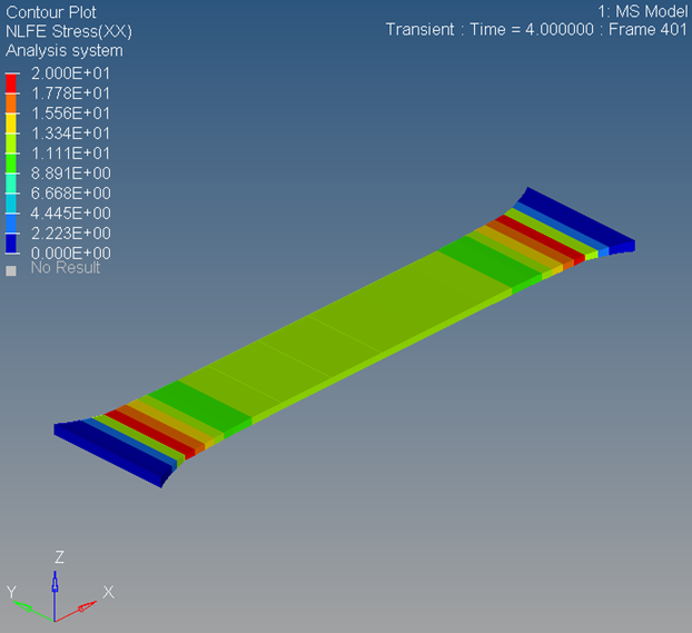

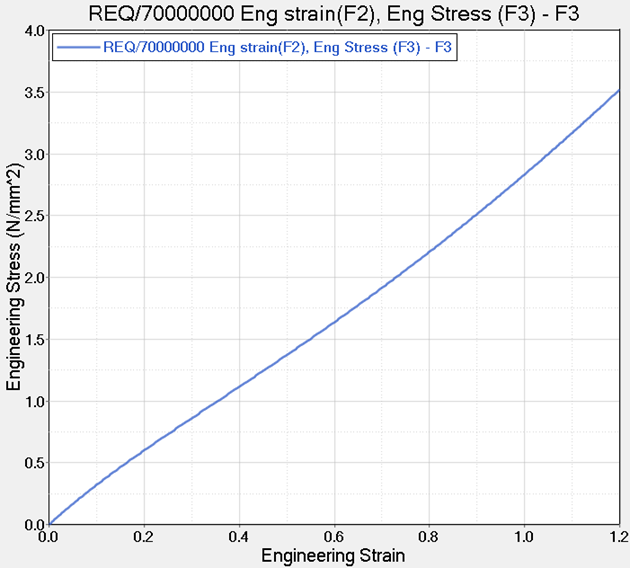

Solve and Post-Process the Model
