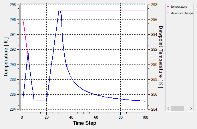

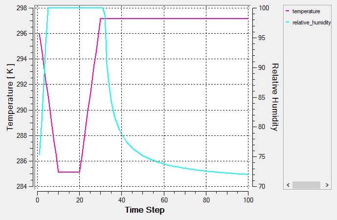

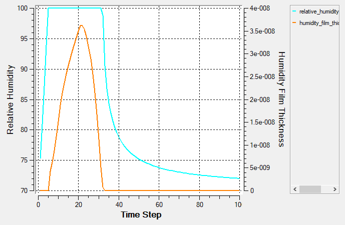

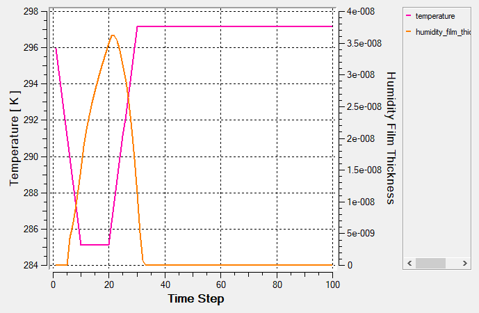

From the above plot, we can see that the Air volume initial temperature is set to 297.15 K. The Bottom Wall temperature drops to 285.13 K over 1 sec, maintains 285.13 K for 1 sec, and then rises back to 297.15 K over 1 sec. The dew point temperature of the air at 70% RH is 291.14 K and is reached at 0.5 and 2.5 sec. On the whole we can see that both condensation and evaporation occurs when the dew point temperature is reached, as explained above.

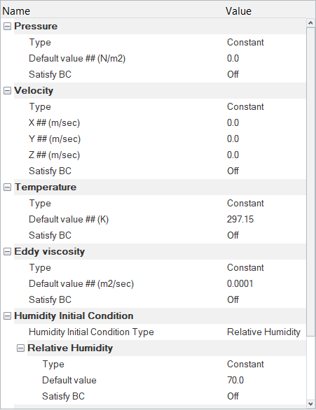

Set Up Nodal Initial Conditions

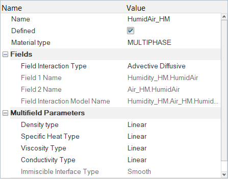

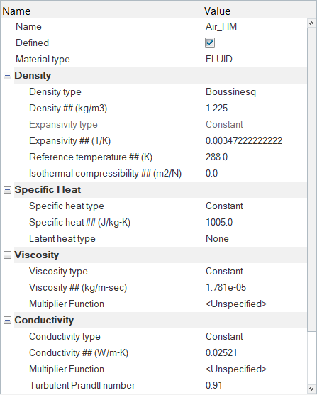

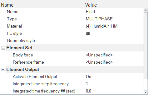

Set Up Material Model Parameters and Body Force

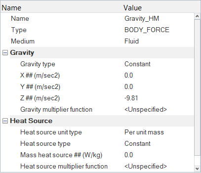

In this step, you will define the material properties for the problem and assign body force to the fluid volume.
Set Material Model Parameters
Set Up Body Force

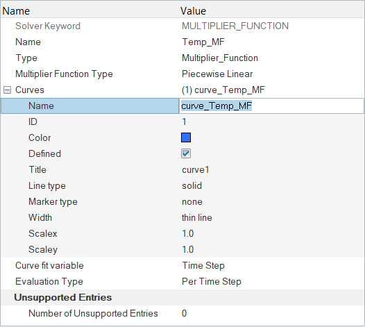

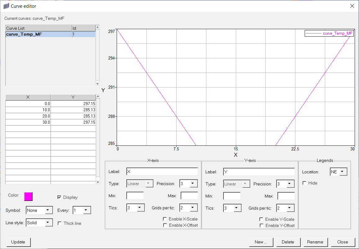

Create a Multiplier Function

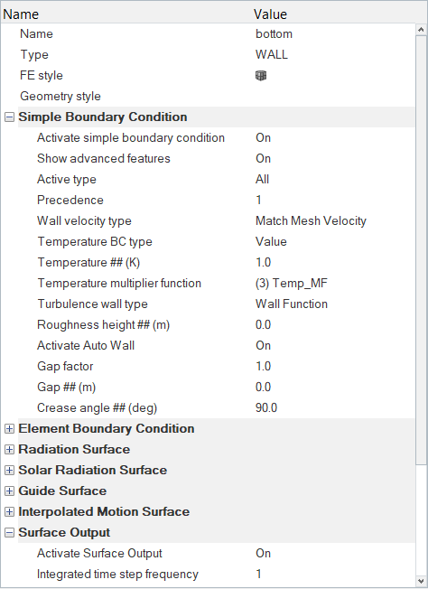

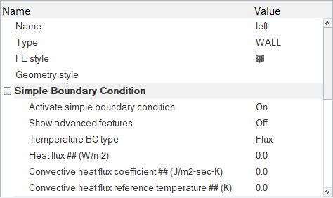

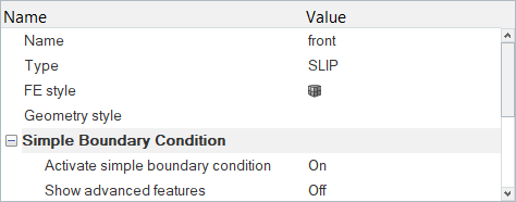

Set Up Boundary Conditions

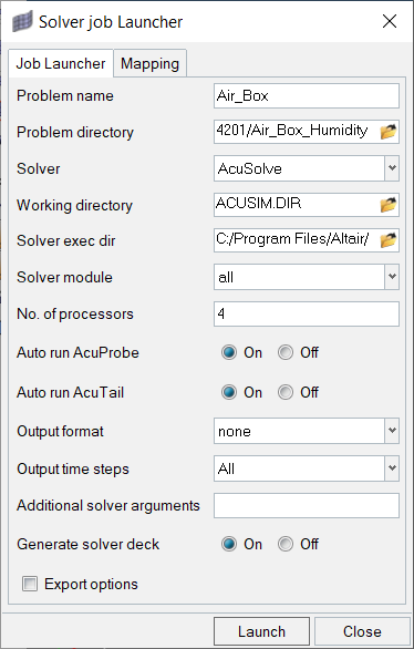

In this step, you will launch AcuSolve directly from HyperMesh and compute the solution.

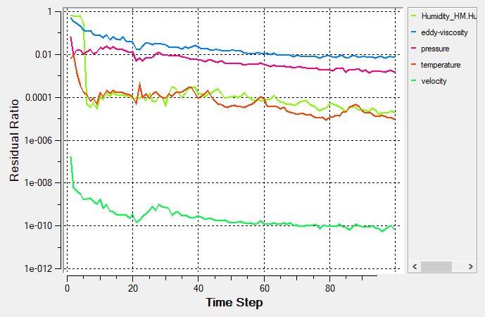

Monitor the Solution with AcuProbe

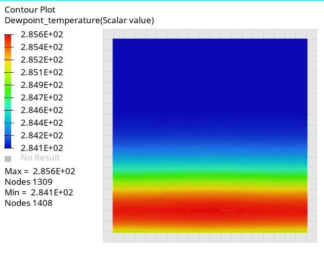

Post-Process the Results with HyperView

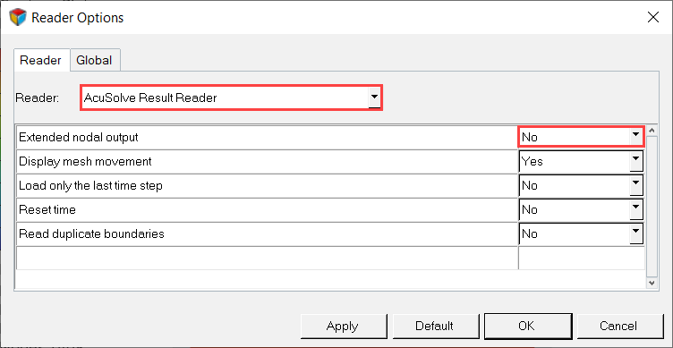

Open HyperView and Load the Model and Results

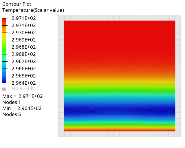

Create Contours on a Cut Plane
