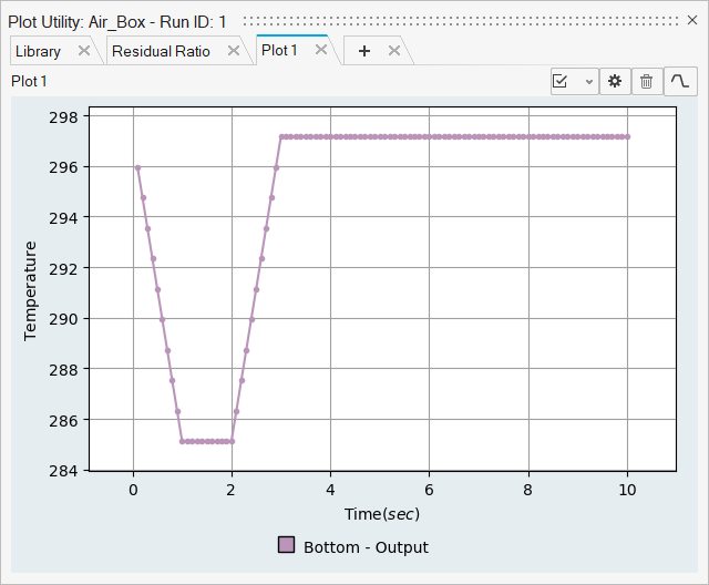

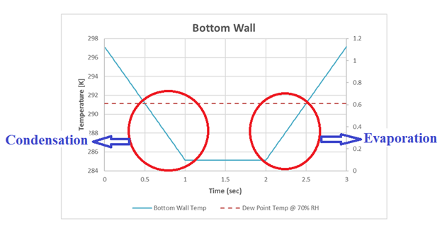

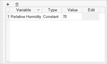

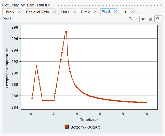

From the above plot, we can see that the Air volume initial temperature is set to 297.15 K. The Bottom Wall temperature drops to 285.13 K over 1 sec, maintains 285.13 K for 1 sec, and then rises back to 297.15 K over 1 sec. The dew point temperature of the air at 70% RH is 291.14 K and is reached at 0.5 and 2.5 sec. On the whole we can see that both condensation and evaporation occurs when the dew point temperature is reached, as explained above.

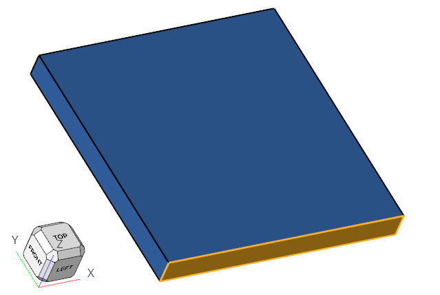

Validate the Geometry

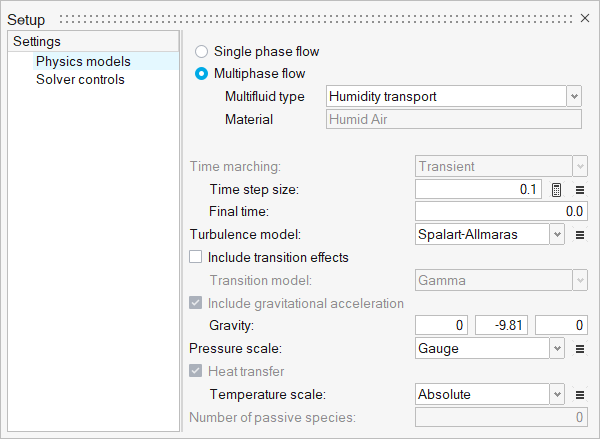

Set Up Flow

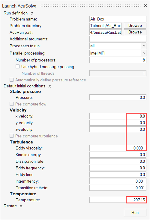

Define the Nodal Initial Conditions
Run AcuSolve

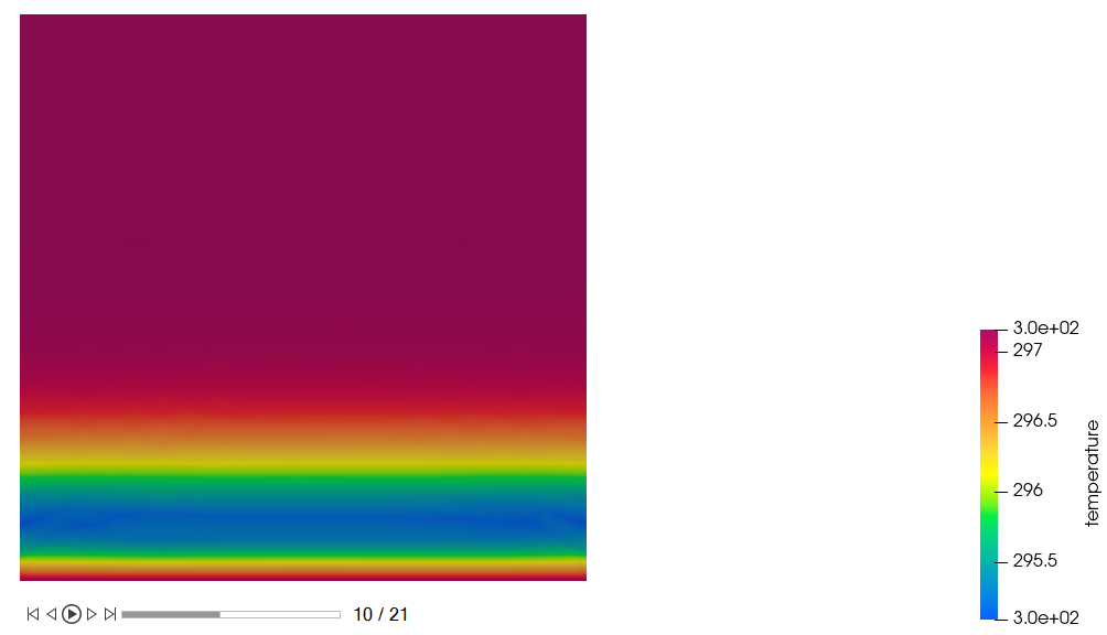

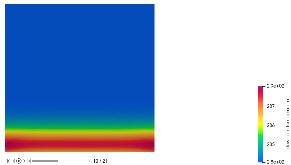

In this step, you will create contour plots for temperature, relative humidity, and dew point temperature.

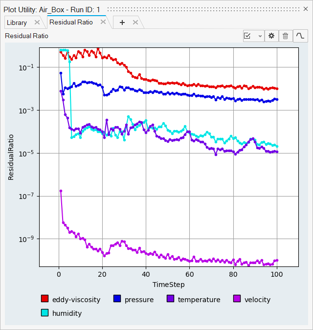

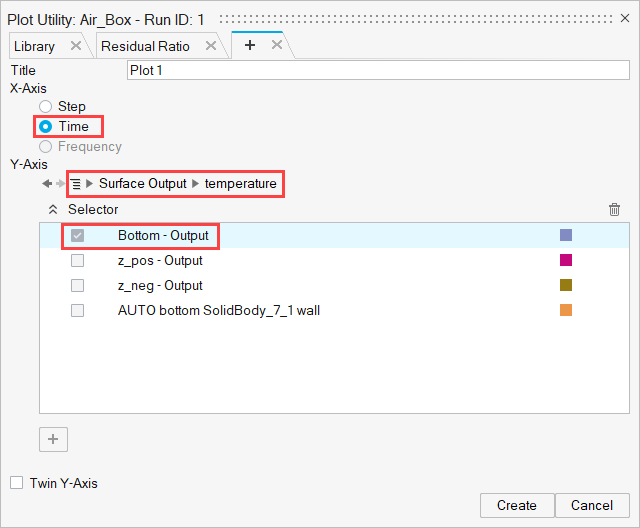

In this tutorial, you learned how to set up and solve a multiphase humid air condensation and evaporation simulation using HyperWorks CFD and AcuSolve. You started by importing the HyperWorks CFD input database and then defined the flow setup. Once the solution was computed, you created a plot of residual ratios using the plot utility in HyperWorks CFD. Finally, you created a contour plot of temperature distribution, relative humidity, and dew point temperature using HyperWorks CFD Post.
