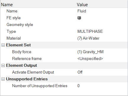

Create a Multiphase Model and Set the Body Force
Create a Multiphase Material Model
Set the Body Force
