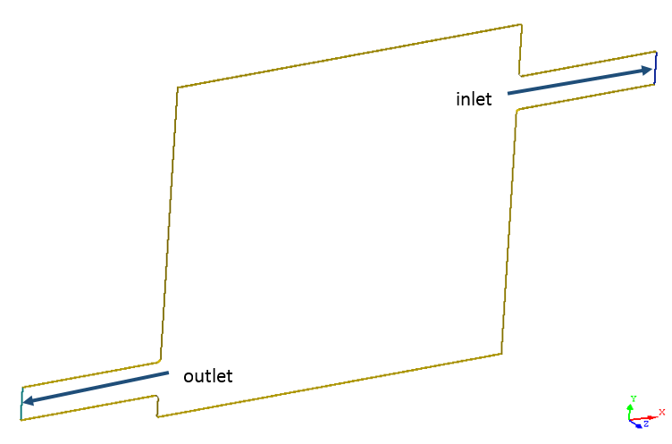

Analyze the Problem

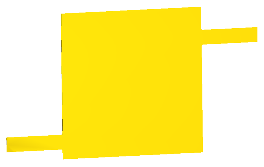

An important step in any CFD simulation is to examine the engineering problem at hand and determine the important parameters that need to be provided to AcuSolve. Parameters can be based on geometrical elements (such as inlets, outlets, or walls) and on flow conditions (such as fluid properties, velocity).
In general, multiphase flows are mainly observed in real life environment, consisting of two or more fluids (gas, liquid, or solid). They have possible combinations of gas-liquid (dissolved gas), liquid-liquid (oil in water), liquid-solid (immersed particles), as well as gas-liquid-solid. The first two are examples of two-phase immiscible flows. The two-phase immiscible flows can be solved by tracking the interface between the two-phases. This tutorial will guide you through how to set up the two-phase flow problem using the level set method.
Figure 1. Schematic of the Problem

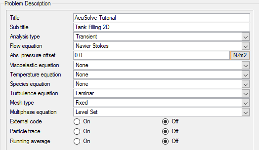

Set General Simulation Parameters
In next steps you will set parameters that apply globally to the simulation. To make this simple, the basic settings applicable for any simulation can be filtered using the BAS filter in the Data Tree Manager. This filter enables display of only a small subset of the available items in the Data Tree and makes navigation of the entries easier.

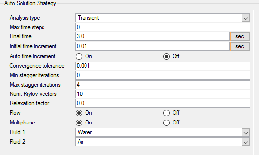

Set Solution Strategy Parameters

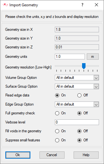

Import the Geometry and Define the Model
Import the Geometry

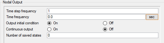

Define Nodal Outputs
The nodal output command specifies the nodal output parameters, for example, output frequency and number of saved states.

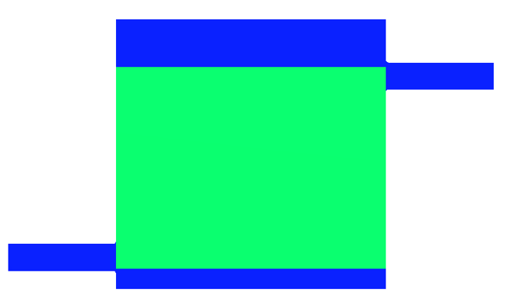

Set the Initial Conditions

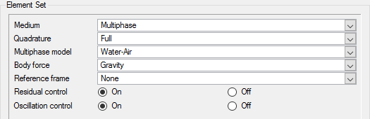

Apply Volume Parameters
Volume groups are containers used for storing information about a volume region. This information includes solution and meshing parameters applied to the volume and the geometric regions that these settings are applied to.
When the geometry was imported into AcuConsole, all volumes were placed into the "default" volume container.
Since the model for this tutorial has only a single volume, it will be the only volume in the default volume group when the geometry is imported. Even when there is a single volume in the model, it is advisable to rename the volume for ease of identification in future. In the next steps you will rename the default volume group container, and set the material and other properties for it.

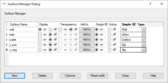

Create Surface Groups and Apply Surface Attributes
Surface groups are containers used for storing information about a surface, including solution and meshing parameters, and the corresponding surface in the geometry that the parameters will apply to.
In the next steps you will define surface groups, assign the appropriate settings for the different characteristics of the problem, and add surfaces to the group containers.
In the process of setting up a simulation, you need to move into different panels for setting up the boundary conditions, mesh parameters, and so on, which can sometimes be cumbersome (especially for models with too many surfaces). To make it easier, less error prone, and for saving time two new dialogs are provided in AcuConsole which you can use to verify and provide the information for all surface or volume entities at once. They are the Volume Manager and Surface Manager. In this section some features of the Surface Manager are exploited.

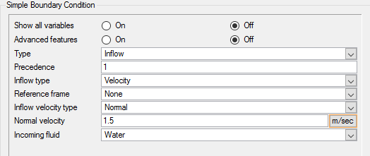

Inlet
As mentioned earlier, the inlet in this problem is a water inlet with inlet velocity set as 1.5 m/s.

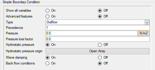

Outlet

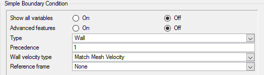

Wall

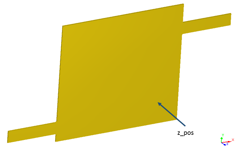

z_pos and z_neg
- In the Data Tree, under Surfaces, expand the z_pos surface.
- Double-click Simple Boundary Condition to open the detail panel.
- Check that the Type is set to Slip.
- Similarly, check that the Simple Boundary Condition type for z_neg is also set to Slip.

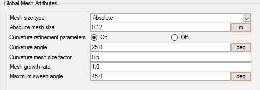

Now that the flow characteristics have been set for the whole problem, a sufficiently refined mesh has to be generated.
Global mesh attributes are the meshing parameters applied to the model as a whole without reference to a specific geometric volume, surface, edge, or point. Local mesh attributes are used to create mesh generation controls for specific geometry components of the model.
In the next steps you will set the global mesh attributes.

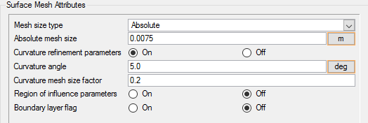

Set Surface Mesh Parameters
Surface mesh attributes are applied to a specific surface in the model. It is a type of local meshing parameter used to create targeted mesh controls for one or more specific surfaces.
Setting local mesh attributes, such as surface mesh attributes, is not mandatory. When a local mesh attribute is not found for a component, the global attributes are used as the mesh generation control for that component. If a local mesh attribute is present, it will take precedence over the global setting.
In the next steps you will set the surface meshing attributes.

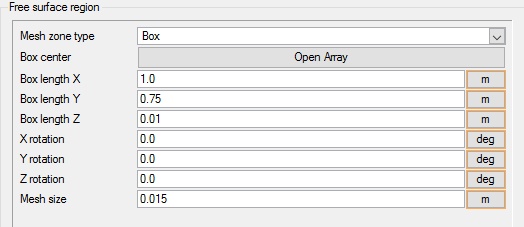

Set Zone Meshing Parameters
In the last section, it was mentioned that surface mesh attributes are local mesh attributes that are applied to a specific surface. Similarly, there is a provision for edge mesh attributes that are local to a specific edge in the model. However, at times it is desired to specify a mesh attribute local to a region independent of the CAD entities in the model. This can be achieved using Zone Mesh Attributes. It is possible to specify a zone in the shape of a box, cylinder or a sphere for example, with local mesh control attributes to be used within that zone. Wherever this zone overlaps the CAD model, the zonal mesh attributes will be used instead of the global mesh attributes.

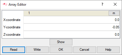

In the following steps, you will define a mesh refinement zone, and set up the zonal mesh attributes for it to be used in the model. A box-shaped refinement zone will be used in the region where a water-air interface is expected.

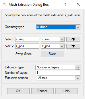

Define Mesh Extrusion
The present simulation is equivalent to a representation of a 2D cross section of the model. In AcuSolve 2D models are simulated by having just one element across the faces of the cross section. Thus when these faces are set up with a similar boundary condition, it coerces the corresponding nodes across the faces to have same results. In this problem, these faces are the negative and positive z-surfaces. This kind of mesh is achieved in AcuSolve with mesh extrusion process. In the following steps you will define the process of extrusion of the mesh between these surfaces.

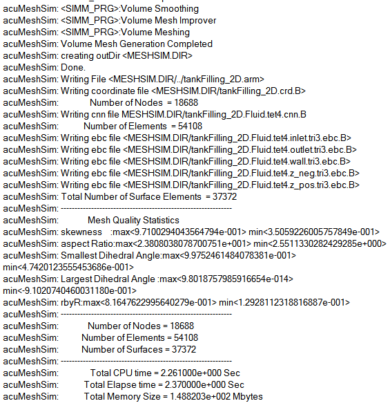

Generate the Mesh
In the next steps you will generate the mesh that will be used when computing a solution for the problem.

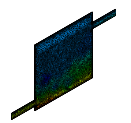

Post-Process with AcuFieldView
- How to find the data readers in the File menu and open up the desired reader panel for data input.
- How to find the visualization panels either from the Side toolbar or the Visualization panel menu to create and modify surfaces in AcuFieldView
- How to move the data around the graphics window using mouse actions to translate, rotate and zoom in to the data.

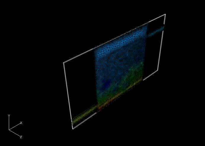

Set Up AcuFieldView

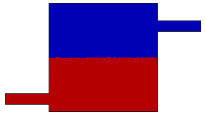

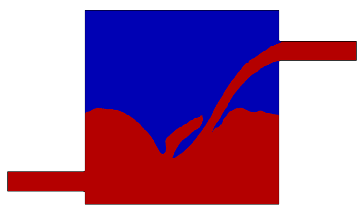

Coordinate the Surface Showing Water-Air Interface on the Mid Coordinate Surface
Visualize the Animation of the Water Flow
If the Sweep Control in this dialog says Sweep instead of Build, the Flipbook Build Mode is not active. In Sweep mode, you will be able to create and visualize the animation but you will not be able to save it. To be able to save the animation, enable the Flipbook Build Mode.
