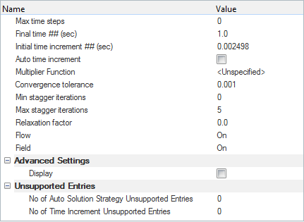

Set the Transient Simulation Parameters
Set the Analysis Parameters
Specify the Solver Settings

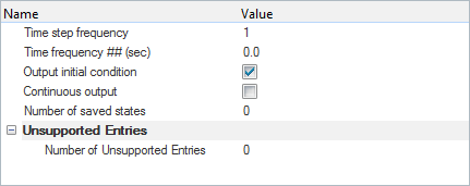

Define the Nodal Outputs

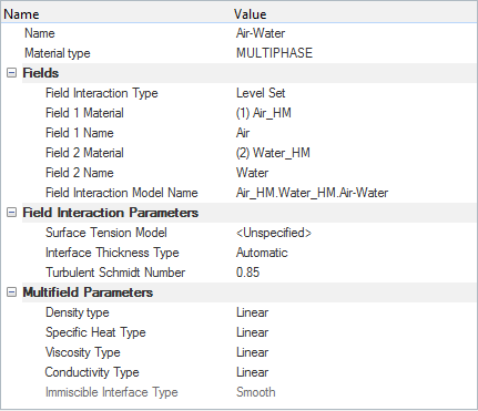

Create a Multiphase Model and Set the Body Force
Create a Multiphase Material Model

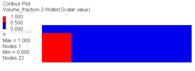

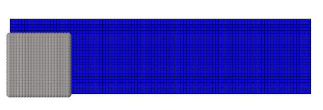

In this step, you will start by creating a node-set for assigning nodal initial conditions for volume fraction. All the nodes in the set are assigned a volume fraction of 1 for water, thereby creating a water column.
Create a Node Set
- Go to the Model Browser, right-click on empty space in the browser area, and select .
- In the Entity Editor, rename the set to Water_Column.
Set the Boundary Conditions

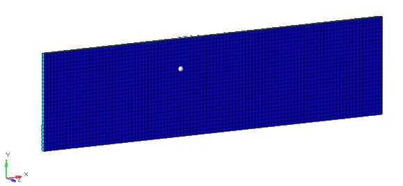

Assign Reference Pressure
Set the Nodal Initial Conditions
Assign Nodes to the Node Set

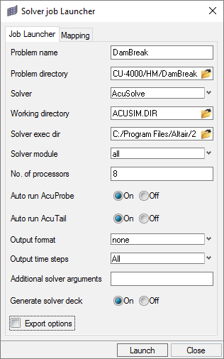

In this step, you will launch AcuSolve directly from HyperMesh and compute the solution.
Run AcuSolve
