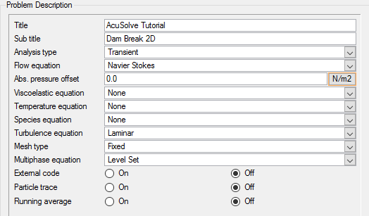

In next steps you will set parameters that apply globally to the simulation. To make this simple, the basic settings applicable for any simulation can be filtered using the BAS filter in the Data Tree Manager. This filter enables display of only a small subset of the available items in the Data Tree and makes navigation of the entries easier.

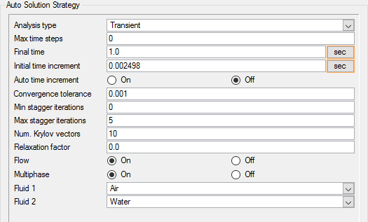

Set Solution Strategy Attributes

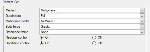

Define the Multiphase Model:
- Under Multiphase Parameters, expand the Multiphase Model item.
- Double-click Air-Water to open the detail panel.
- Set Modify advanced settings to On.
- Click Open Refs next to Field interaction models.
- Check that the entry in the Reference Editor is Air-Water.

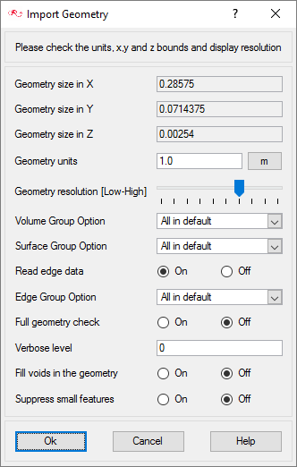

Import the Geometry and Define the Model
Import the Geometry

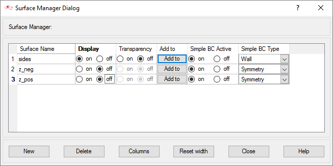

In the process of setting up a simulation, you need to move into different panels for setting up the boundary conditions, mesh parameters, and so on, which can sometimes be cumbersome (especially for models with too many surfaces). To make it easier, less error prone, and for saving time two new dialogs are provided in AcuConsole which you can use to verify and provide the information for all surface or volume entities at once. They are the Volume Manager and Surface Manager. In this section some features of the Surface Manager are exploited.
Assign the Surface Parameters

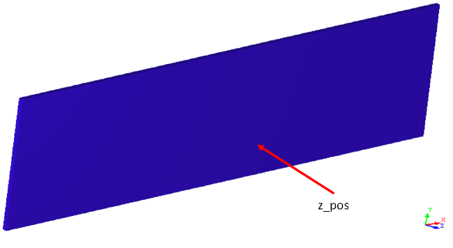

Set up the z_pos and z_neg surface parameters:
- In the Data Tree, under Surfaces, expand the z_pos surface group.
- Double-click Simple Boundary Condition to open the detail panel.
- Ensure the Type is set to Symmetry.
- Similarly, check that the Simple Boundary Condition type for z_neg is also set to Symmetry.
Set up the sides surface parameters:
- In the Data Tree, under Surfaces, expand the sides surface group.
- Ensure the Type is set to Wall.

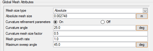

Set Global Meshing Attributes
Now that the flow characteristics have been set for the whole problem, a sufficiently refined mesh has to be generated.
Global mesh attributes are the meshing parameters applied to the model as a whole without reference to a specific geometric volume, surface, edge, or point. Local mesh attributes are used to create mesh generation controls for specific geometry components of the model.
In the next steps you will set the global mesh attributes.

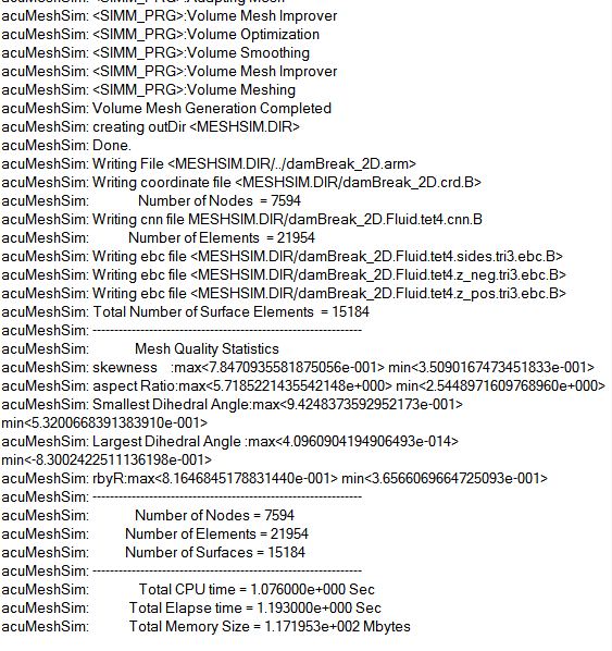

Generate the Mesh
In the next steps you will generate the mesh that will be used when computing a solution for the problem.

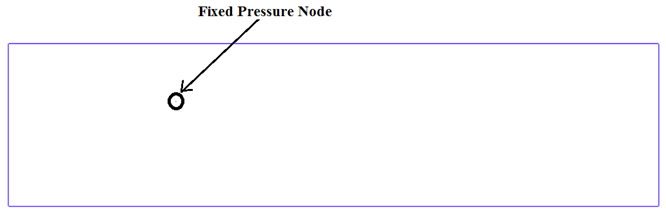

Assign Reference Pressure
The present case does not have any inlet or outlet surfaces to define any boundary condition that sets the pressure level inside the domain. To make the solution more robust, you will set a pressure reference point using a nodal boundary condition. The following steps will show how to setup the reference pressure inside the CFD domain.

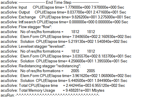

Run AcuSolve
In the next steps, you will launch AcuSolve to compute the solution for this case.

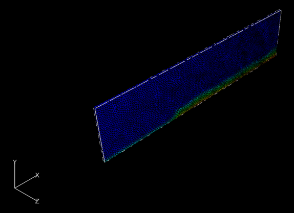

Set Up AcuFieldView

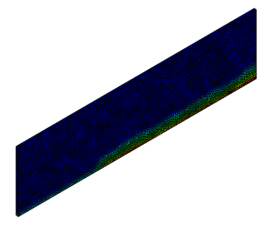

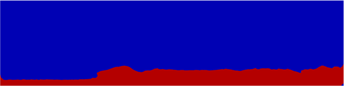

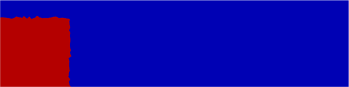

Coordinate the Surface Showing Water-Air Interface on the Mid Coordinate Surface

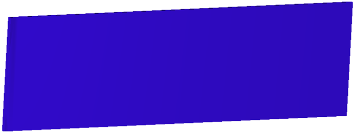

Visualize the Animation of the Water Flow
If the Sweep Control in this dialog says Sweep instead of Build, the Flipbook Build Mode is not active. In Sweep mode, you will be able to create and visualize the animation but you will not be able to save it. To be able to save the animation, enable the Flipbook Build Mode.
