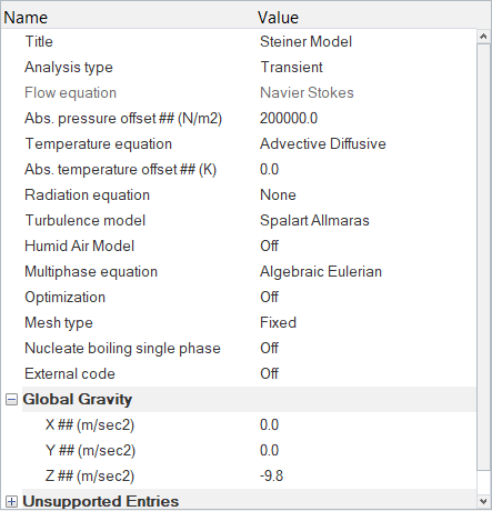

Set the Analysis Parameters
Specify the Solver Settings

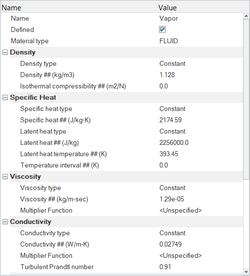

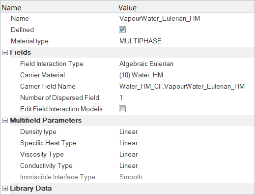

In this step, you will start by creating a new material named Vapor. Then, you will set up the Multiphase material model.

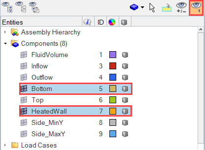

In this step, you will assign the material properties to the multiphase fluid volume and then assign surface boundary conditions.

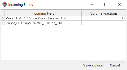

Set the Nodal Initial Conditions

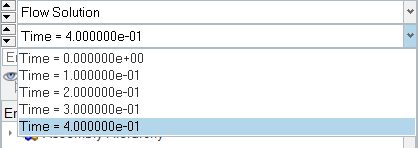

Switch to the HyperView Interface and Load the AcuSolve Model and Results
Create Contours for the Volume Fraction of Vapor
